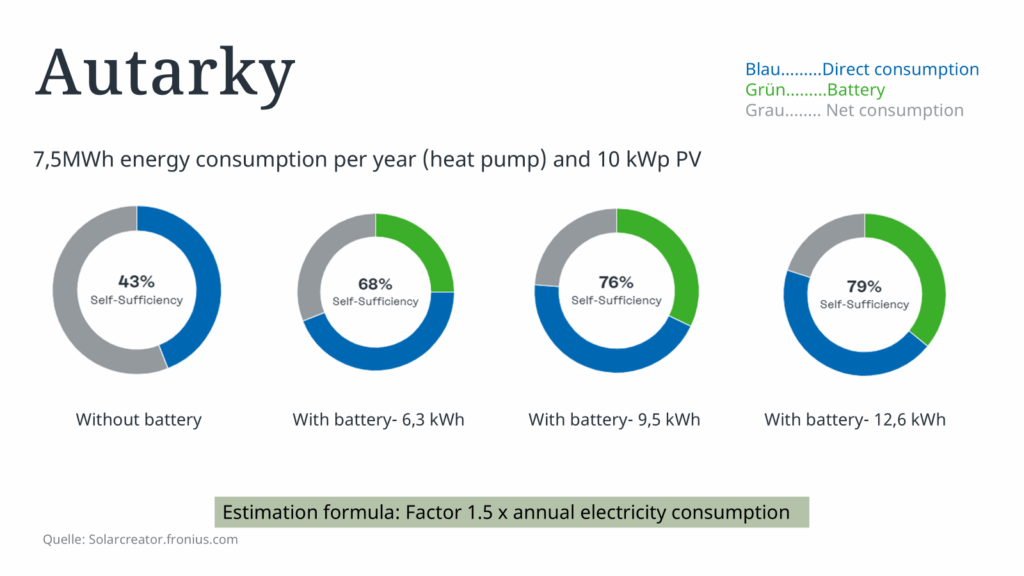

Example: How battery size affects energy independence
Let’s look at a simple example of a home with a 10 kW solar system, a heat pump, and yearly electricity use of 7,500 kWh.
  • With no battery, the home can cover about 43% of its yearly power needs using solar alone.
    (This lines up with typical Australian homes, which reach about 25–40% self‑consumption without storage.)
  • With a 6.3 kWh battery, self‑sufficiency jumps to more than two‑thirds of total usage.
  • Upgrading to a 9.5 kWh battery lifts this to over three‑quarters.
  • Going bigger again, to around 12.6 kWh, adds only a small extra gain.
As the graph illustrates, the maximum degree of self-sufficiency has already been reached with the 12.6 kWh storage system. The calculations come from Fronius Solar.creator, a configuration tool for solar systems.
So as you can see, while a small and, strictly speaking, undersized solar battery can significantly increase the level of self-consumption on its own, the degree of independence increases only slightly with an adequately or oversized storage solution and ultimately, from a certain number of kWh, there is no further improvement at all.

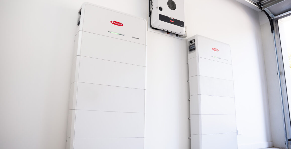

DC‑Coupled Batteries
DC‑coupled batteries sit on the solar side of your system, before the inverter. This means they can charge directly from the energy your panels produce, without extra conversions.
When paired with a hybrid inverter, these batteries allow full system monitoring and often support backup power. Many setups can keep your home supplied with stored solar energy during a blackout, and some can even restart themselves without help. If you’re unsure what “Full Backup” or “black‑start capability” means, don’t worry, we’ll explain these terms in this article.

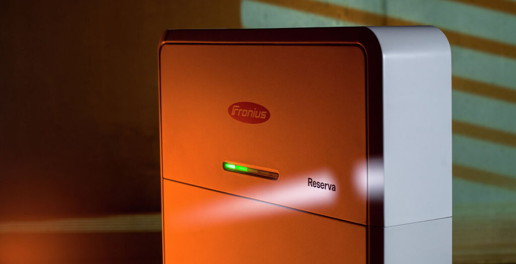

“Solar storage devices of this type communicate best with a hybrid inverter and optimise self‑consumption. One example of a DC‑coupled storage solution is our Fronius Reserva,” says solar expert Schett.
The Fronius Reserva also offers extra benefits, including a ten‑year performance guarantee, black‑start capability, and strong data protection.
The Fronius Reserva impresses with a ten-year performance guarantee and European data security. It has been designed for optimal interoperability with Fronius inverters.
