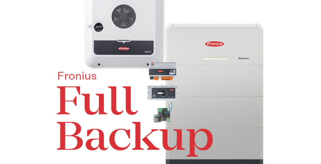

2. Automatic switching to full backup mode
If you want your whole home to stay powered automatically during a blackout, you’ll need an automatic switch that takes over when the grid goes down. This device senses a power failure within moments and safely disconnects your home from the grid. It then switches your solar and battery system into backup mode on its own. When grid power returns, it reconnects everything back to normal without you needing to do anything.
There are a few types of automatic switching units available. Options include switchover boxes, backup controllers and transfer switches. Each suits different home setups and system sizes. Switchover boxes simply switch between grid power and backup mode during an outage. Backup controllers also manage how solar and battery power is used. Transfer switches are designed for bigger, high‑demand systems.
In short: With an automatic switching unit—such as the Fronius Backup Controller—your entire home can stay powered even when you’re not there. It delivers strong energy security and real peace of mind during longer outages.

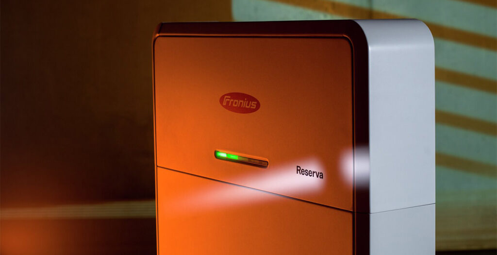

3. Manual start pulse (dark start)
A button or switch on the battery (e.g., on the Fronius Reserva) is pressed manually to activate the system. The battery supplies a small amount of residual energy to start the inverter and the control electronics.
4. Stand-alone grid is established
The inverter establishes a stable stand-alone grid. Single phase (230V) or Three phase (400V).
Loads can be supplied again.
5. Solar system starts to work (in daylight)
The solar system starts up as soon as sunlight is available. The electricity generated is first used for actual consumption and then for charging the battery.
6. System continues to run autonomously
The system remains in stand-alone operation until the public grid is available again. It can then switch back to parallel grid operation automatically or manually.
