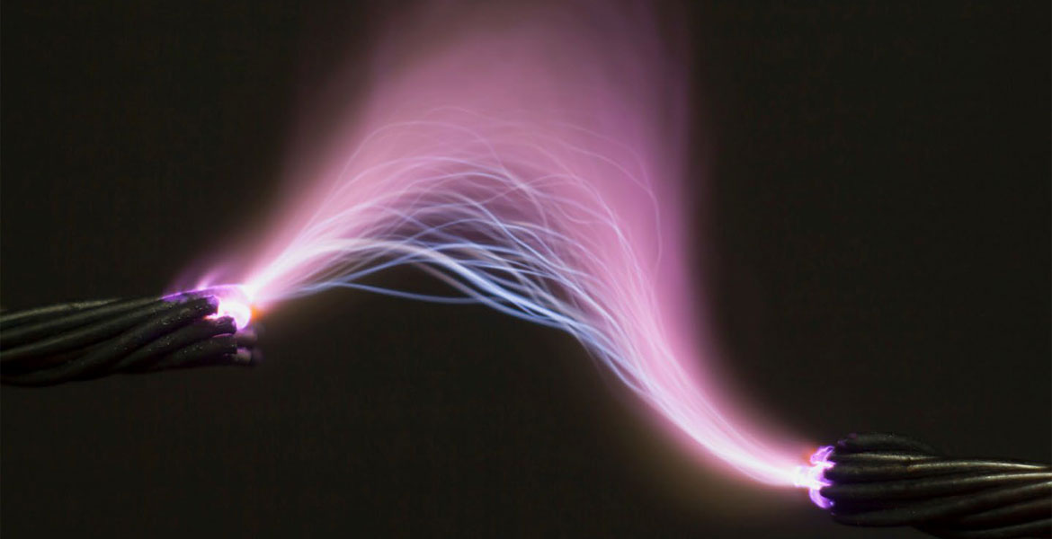

The most common causes of fire in photovoltaic systems include material fatigue and corrosion, but the primary reason is faulty installation: serial arcs caused by loose contacts, poorly crimped (i.e., mechanically compressed) plugs, damaged cables, or incompatible plug connections are particularly dangerous. If, for example, MC4 plug connections from different manufacturers are installed in a photovoltaic system, they differ not only in terms of materials, but also when it comes to degradation and thermal expansion, which can result in a temperature increase of up to 97 °C at the contact points.
The upshot? Arcs that can reach temperatures of over 1,000 °C; enough to ignite surrounding material and cause damage that is sometimes not covered by insurance. The independent international standards organization (IEC) therefore stipulates the use of plug components from the same manufacturer.
Arcing process in a conductor:
1. Reduction in the conductor cross-section
2. Higher contact resistance → increased heat generation at the contact point
3. Higher temperature accelerates the deterioration process → further reduction in cross-section and increase in contact resistance (loop between steps 2 and 3)
4. At a certain point, the continuity of the conductor is interrupted
