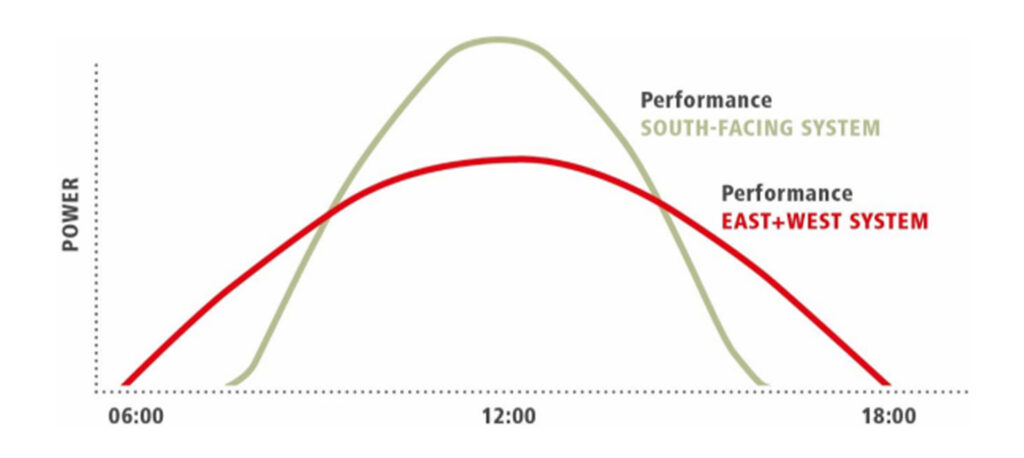

Opting for an east-west solar panel orientation
As shown in the table above, east-west oriented solar panels are associated with yield losses, but they also offer significant advantages.

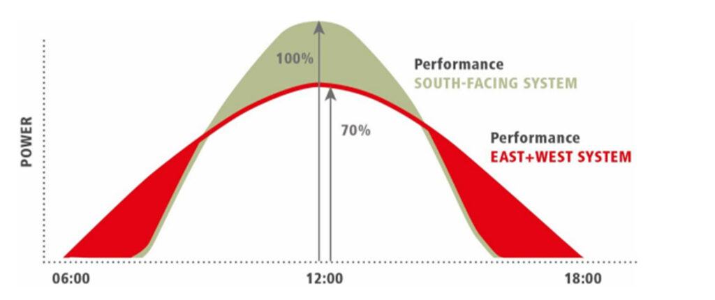

While solar modules facing south reach their peak output around midday and thus potentially generate large PV surpluses, an east-west orientation offers much more even power generation from sunrise to sunset. Reinbrech adds: “Even if the components rarely or even never reach their maximum potential output in this constellation, the continuous supply of solar power often reduces the financial burden on households more than a south-facing system—especially in homes without a battery storage solution. East-west systems ensure a moderate amount of energy is available for self-consumption throughout the day, including in the mornings and evenings when the energy requirements for many families peak. After all, this is usually when we get the coffee machine brewing, load the washing machine, or put the TV on.”
The power curve of an east-west system is flatter, but much broader than that of a south-facing system.
There is a further advantage of east-west systems that should not be underestimated: if solar modules and inverters are not running at full load, their components will not reach critically high temperatures. This not only protects the components themselves but increases their service life. It may even be worth opting for an inverter with a lower output to reduce the purchase costs.
While modules and inverters reach their performance limits with a south-facing orientation, they work longer with an east-west orientation but never at full load.

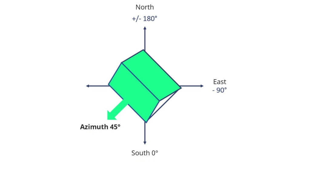

What is the azimuth angle and why is it important for solar panels?
Whether a solar power system is aligned to the south, east, or west can be easily determined by the azimuth angle. But how? All is revealed below.
The azimuth angle determines the deviation from the horizontal and can be a maximum of 180 degrees on a sphere such as the Earth. In applications such as cartography and astronomy, it indicates the deviation from true north. For photovoltaic systems, on the other hand, it denotes the deviation from “true” south.
The combination of azimuth and tilt angle ultimately determines how much of the theoretical maximum yield a PV system can generate.
In concrete terms, this means:
/ The azimuth angle at the exact south is 0 degrees—and this is where the maximum solar power is generated.
/ An azimuth angle of 90 degrees indicates an orientation to the west, while -90 degrees is to the east.
/ A 45 degree angle means an orientation to the south-west and -45 degrees is south-east.
/ North corresponds to an azimuth angle of 180 degrees.
The azimuth angle of 0 degrees indicates an orientation to the south, while 90 degrees shows an orientation to the west.
