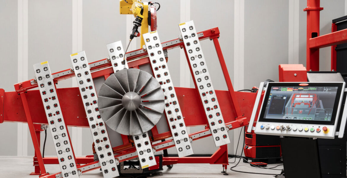

MIG/MAG (CMT) robotic welding cell. HMI-T21 system controls guarantee real-time views in 3D, while the high-resolution ArcView 2 weld seam monitoring camera provides a direct view of the weld pool.

Feasibility studies are initially carried out at the Fronius site in Wels, followed by prototype production if requested. This requires that the client submit their welding specifications as well as the 3D data of components and clamping devices. Fronius performs a virtual analysis of this information, in order to draw conclusions about weldability, accessibility, and cycle time. Problems that arise are discussed together with the customer and optimization and solution options are developed.
The prototype of a bogie is welded in a robotic welding cell with a torch changing station. Welding processes: CMT & CMT TWIN (double-wire solution).
