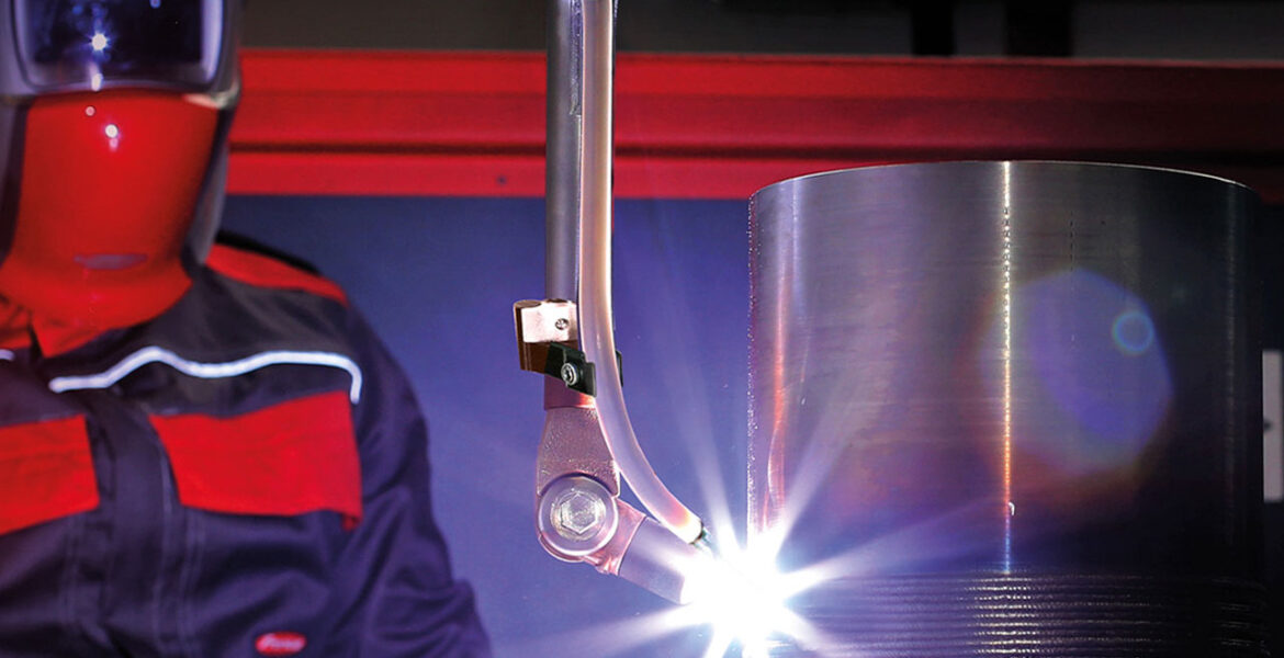

For this reason, in practice, clad welding is usually carried out automatically using TIG hot-wire (TIG-HW) or the Cold Metal Transfer (CMT) process. A crucial quality factor is the dilution, which describes how much of the workpiece base material mixes with the applied material. A small amount of dilution is necessary for the applied material to retain its special properties, such as the desired high level of corrosion resistance.
Clad welding techniques in detail
Cladding essentially involves building up volume in the form of a top layer using welding filler metals such as wire or powder. Suitable special alloys such as Alloy 50 and 625, CrMo 910, or Inconel 625 are used for this purpose, which results in a significant advantage when it comes to surface coating: conventional steel can be combined with high-quality alloys, making cladding particularly economical.
Detailed view of cladding layer build-up
Due to the extremely high safety requirements in the oil and gas industry, TIG hot-wire welding is primarily used. However, laser cladding and plasma powder cladding are also common methods. It is impossible to say with certainty which method is best, as each approach offers specific advantages that need to be considered depending on the material, component size, and requirements.
TIG hot-wire welding for absolute precision
TIG-HW is a further development of conventional TIG (Tungsten Inert Gas) welding. In this process, an additional wire is electrically preheated before it is introduced into the melting area. This leads to a significant improvement in the deposition rate and efficiency of the welding process, minimizing defects such as cracks or deformation.
As a result, TIG-HW is extremely versatile and produces a high-quality surface with even, spatter-free welds that meet even the most stringent safety standards. The only disadvantage is that TIG hot-wire welding is very time-consuming, especially when it comes to large components or series production.

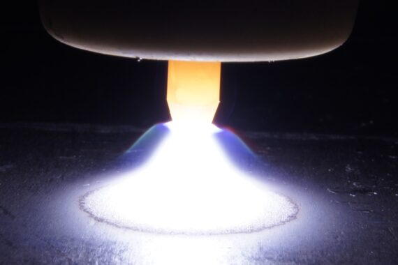

The SpeedClad 2.0 effectively answers this challenge. This high-tech clad welding process developed by Fronius makes significantly higher welding speeds of up to 110 cm/min (43 in/min) possible with just one specially shaped electrode and an additional wire. The slim welding torch also enables surfacing of small internal diameters from 100 millimeters (4 inches).
