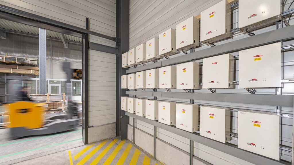

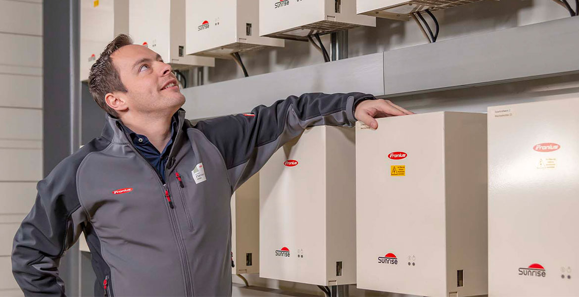

Twenty-seven years ago, 30 of the first Fronius solar inverter, the Fronius Sunrise, were installed in Vorarlberg, Austria. Since 1999, they have formed the core of an extraordinary photovoltaic system with a facade construction. This is a statistical outlier, as the average lifespan of a solar inverter is half that. Why do some power converters last longer than others? What factors play a role, and how can you extend the the service life of your own device? Discover our essential tips for longer solar inverter lifespan.
In the late 1990s, the two sister companies doma vkw Energietechnik and Ernst Schweizer GmbH seemed to have struck gold. As a photovoltaic system installer and now a Fronius partner, doma vkw Energietechnik independently commissioned the 49 kWp facade-mounted system at its own site in 1999. Its core components—more than 30 solar inverters—are still providing affordable solar power today, 27 years later. And this is despite the fact that the average service life of an inverter is only 10 to 15 years.
Only two solar inverter issues in 27 years
Martin Frick, the current managing director of doma vkw, says: “We deliberately opted for Fronius. At that time, the Sunrise was still a very new product, but the quality has convinced us over the years. Two inverters have failed in 27 years, but that’s not a big deal as we’d bought three in reserve. The third spare inverter is still knocking about, waiting for the chance to replace one of the other inverters.

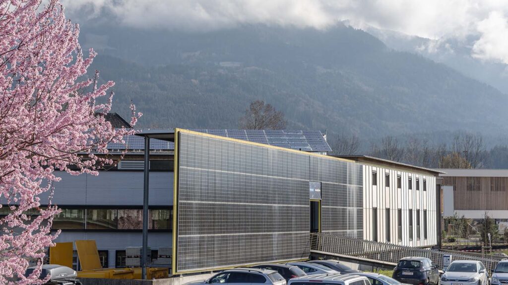

Our example system in Vorarlberg, which features more than 30 Fronius Sunrise units, demonstrates that investing in high-quality PV components pays off in many ways. Not only has the PV system been generating electricity for 27 years, but it has also been awarded the European Solar Prize. Managing director Martin Frick is convinced: “Our facade system, combined with the Fronius Sunrise, was already a very innovative solution back then. Today we are still committed to offering our customers only the best, the latest, and the most innovative products. That’s why we rely very strongly on our partner Fronius.

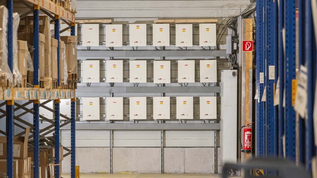

The Fronius Sunrise inverters in our demonstration system in Vorarlberg do not feature such advanced cooling technology. They date back to a time when passive cooling was the industry standard. “In this process, natural convection—that is, the rising of warm air and the sinking of cooler air—carries away the heat. If space is limited and multiple inverters are arranged closely together—especially one on top of the other—this can lead to heat build-up. The operating temperature increases and the long lifespan suffers,” explains Robert Reinbrech. However, doma vkw positioned the Fronius Sunrise devices cleverly: there is enough space between the individual units to allow for proper air circulation.

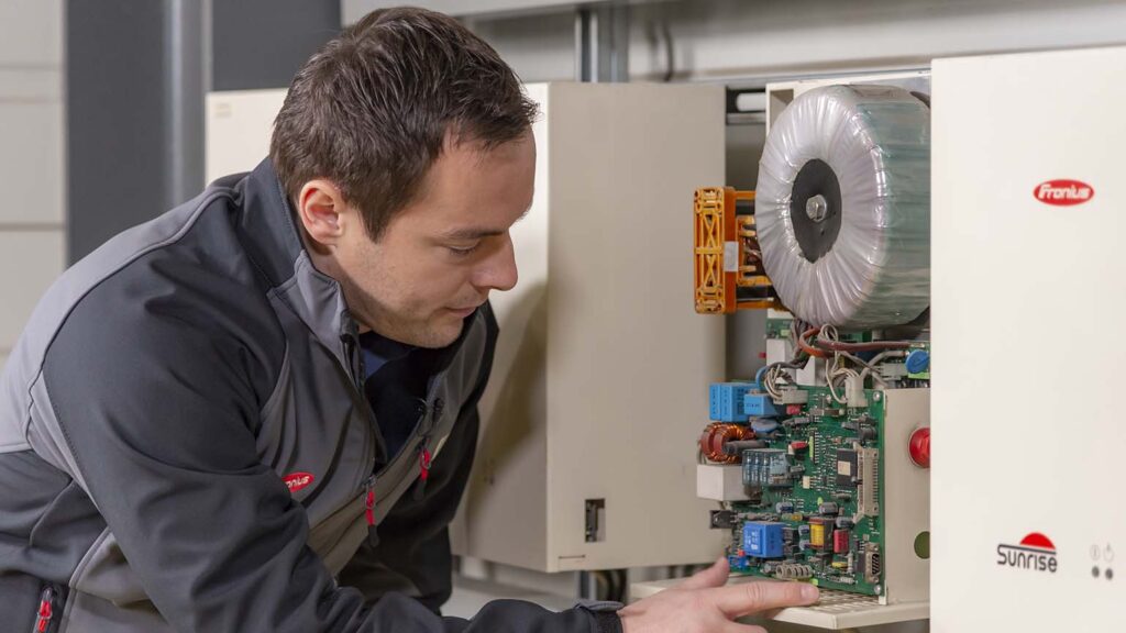

Opening the device should be left to a professional. As a solar expert, doma vkw can easily perform any necessary maintenance work on their own
