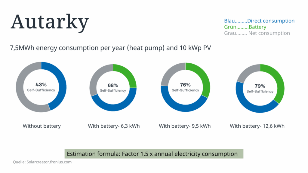

However, it is not automatically the case that the larger the storage capacity, the greater the degree of independence. The graph below illustrates this using the example of a household with a 10 kWp PV system, a heat pump, and an annual electricity consumption of 7,500 kWh. Without a storage solution, the example household can only cover 43% of its annual electricity needs with solar energy.
If the household invests in a smaller energy storage device with a capacity of 6.3 kWh, the self-sufficiency rate increases to more than two thirds. A higher charging capacity of 9.5 kWh moderately increases the degree of self-sufficiency even further: more than three quarters of the electricity demand can be covered by self-generated solar energy. An even larger energy storage device with a storage capacity of 12.6 kWh, on the other hand, only marginally increases the degree of independence.
As the graph illustrates, the maximum degree of self-sufficiency has already been reached with the 12.6 kWh storage system. The calculations come from Fronius Solar.creator, a configuration tool for PV systems.
So as you can see, while a small and, strictly speaking, undersized solar battery can significantly increase the level of self-consumption on its own, the degree of independence increases only slightly with an adequately or oversized storage solution—and ultimately, from a certain number of kWh, there is no further improvement at all.

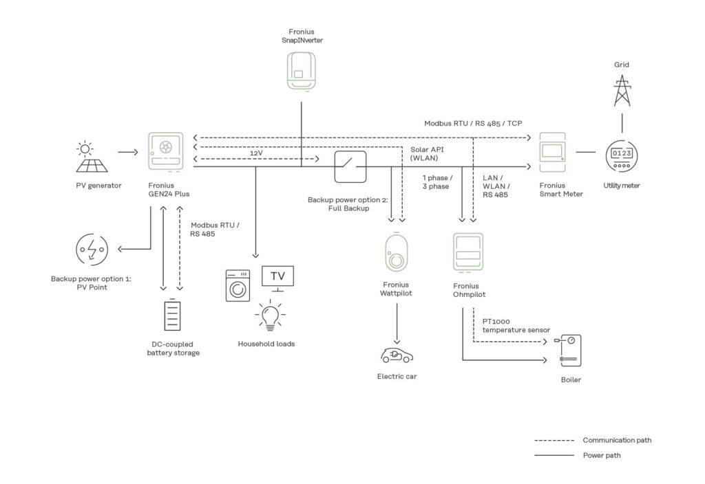

DC high-voltage batteries
DC-coupled energy storage devices are located in the circuit upstream of the PV inverter and can be charged with solar power directly from the roof. In conjunction with a compatible hybrid inverter, they enable comprehensive system monitoring and many also come with an emergency power function (meaning they can supply the household with surplus PV energy in Full Backup mode in the event of a power outage). Some are even black-start capable. Find out exactly what is meant by “Full Backup” and “black-start capability” in this blog post.
A diagram illustrating PV energy sector integration with a DC-coupled energy storage device that communicates directly with the hybrid inverter.
PV storage devices of this type communicate best with a hybrid inverter and optimize self-consumption. One example of a DC-coupled storage solution is our Fronius Reserva,” says solar expert Schett. Incidentally, the Fronius Reserva comes with further benefits such as a ten-year performance guarantee, the black-start capability mentioned above, and European data security. Fronius inverters are also compatible with a range of partner batteries.
