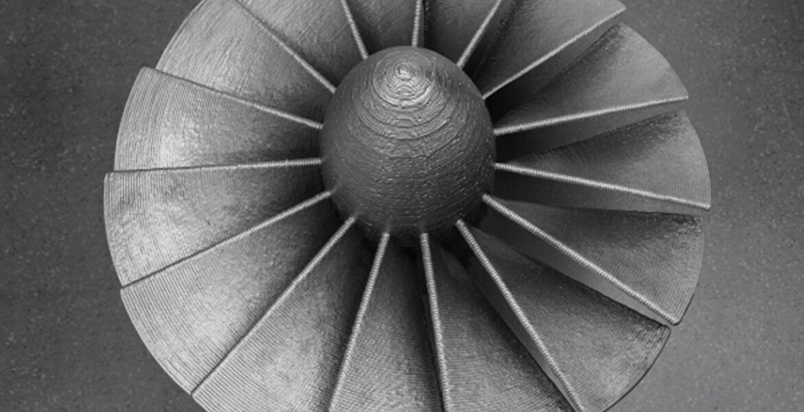

It is clear to see why the number of metal construction companies adopting 3D printing, known as simply WAAM (Wire Arc Additive Manufacturing) in the industry, is on the rise. The growing demand for modern, individualized production facilities is closely followed by the desire for customized single solutions. Time and again, we need non-standard spare parts within the shortest possible time. And in prototype construction, we aim not only to save on tool costs but also to shorten development times. When it comes to meeting all these demands, additive manufacturing demonstrates significant strengths. Component geometries that seemed impossible yesterday are becoming a reality today, layer by layer, with metal 3D printing, precisely when we need them.
WAAM – Less material, less weight, less cost
When comparing metal 3D printing with subtractive processes such as milling, it becomes apparent that Wire Arc Additive Manufacturing consumes significantly less material. The higher the raw material prices, the quicker this type of additive manufacturing pays off.
Elaborate molds, like those required for casting, are also not needed. Instead, we can use modern welding technology to manufacture complex, topology-optimized metal components layer by layer, according to a specific recipe. In technical terms, this recipe is known as an Additive Manufacturing Procedure Specification (AMPS). An AMPS contains everything needed for the perfect “print process”: individual welding instructions (Deposition Procedure Specifications, or DPS), operator and material certificates, as well as the kinematic strategy required for the path planning and motion control of the welding robot.
Material certificates guarantee the production quality of welding wires. Operator certificates ensure that the DED arc robotic welding cells, commonly used in additive manufacturing, are only operated by skilled specialists. DED arc stands for Directed Energy Deposition Arc, which is an arc used for the layer-by-layer melting of welding wire.
“In topology optimization, we aim to ensure the ideal material distribution of components. Specifically, the goal is to reduce weight while maintaining rigidity,” explains metal 3D printing expert Philipp Roithinger, adding: “Typical applications include bionic, nature-inspired structures, like those found in the aerospace sector, for example. Another advantage of metal 3D printing is the ability to produce in a decentralized way. Unlike series production, no production lines are needed regardless of location. Additive manufacturing with welding wire relies on specially equipped robotic welding cells that can be used flexibly worldwide. Today, the use of metal 3D printing is increasing in any application where our aim is to reduce weight, material, costs, and environmental impact in metal construction.”
