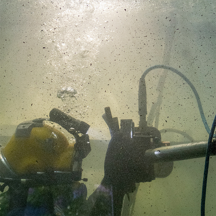

Wet vs. hyperbaric welding: what are the differences?

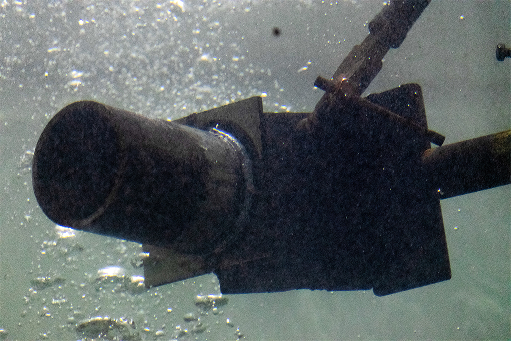

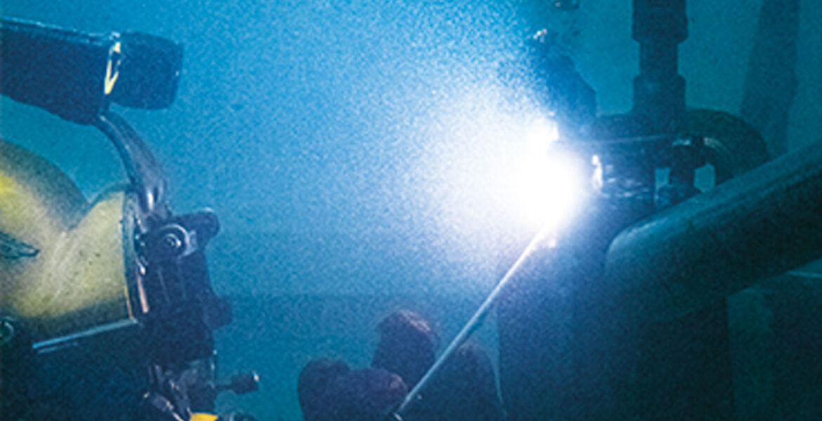

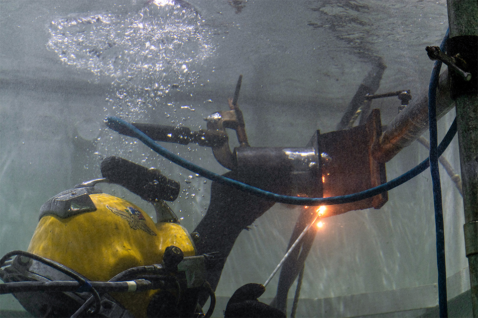

There are two types of underwater welding: wet welding and dry or hyperbaric welding. Wet underwater welding involves the welder working directly in the water, with no mechanical barrier between the water and the arc.
This type of welding is often used when a quick and flexible solution is needed (such as urgent repairs), primarily with an electrode.

Poor visibility
The rules of the game change completely for welding under water. Cloudy water, darkness, suspended particles, and air bubbles make it difficult to clearly see the arc and the weld pool.
At the same time, the surrounding water constantly cools the weld, which makes the process more unstable. This is particularly problematic when it comes to wet welding, as it is more difficult to control the weld seam quality, and the risk of more brittle or crack-prone joints increases.

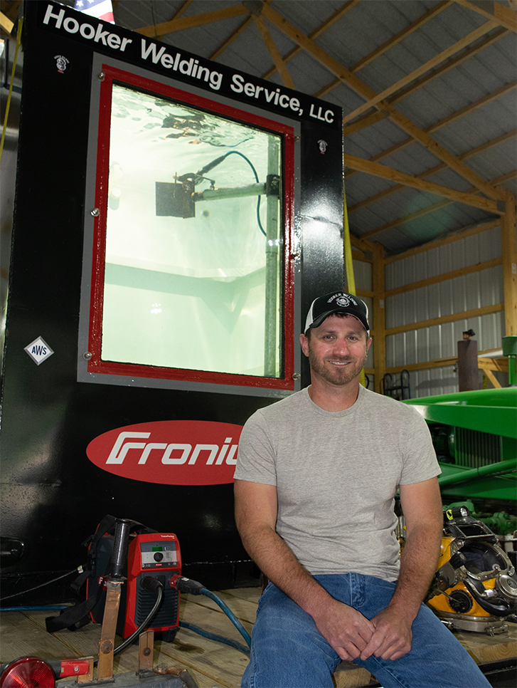

The right welding machine for underwater welding
Welding underwater requires welding equipment that:
- work reliably under demanding conditions;
- can be safely integrated into the diving and welding system;
- are compatible with special underwater electrodes; and
- remain flexible enough to be used even in remote locations.
The Fronius Ignis Battery, for example, enables electrode welding without a mains connection and was developed specifically for work in areas far from fixed infrastructure. Kirk Hooker also uses Fronius welding machines like the Ignis Battery for underwater welder training and demonstrations, demonstrating how mobile welding technology has proven itself even in this demanding field.
Welding equipment also includes:
- Underwater electrodes with a waterproof coating, which are designed for direct use in water and are typically operated at higher amperages than comparable electrodes on land
- specially insulated electrode holders, which provide additional electrical safety during underwater welding
- Welding power leads and power supply systems, which are monitored from the surface
Important to know: With underwater welding, the welding machine is always located on the surface. The current is transmitted under water to the welding site via specially insulated welding power leads. For safety reasons, the welding current is first turned on at the diver’s command (“Make it hot”) and turned off again once the work is complete (“Make it cold”).

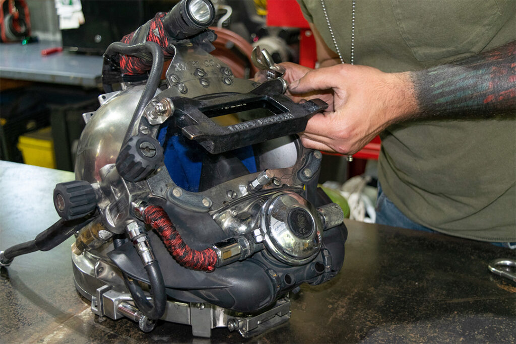

Diving equipment
In addition to the proper welding equipment, underwater professionals also require the following:
- Diving helmet or full-face mask with a communication system
- Breathing gas supply from the surface
- Supply hose (umbilical) for breathing gas, communication, and other supply lines
- Dry diving suit or heated diving system for working in cold water
- Buoyancy control devices (BCDs) for controlling buoyancy during certain underwater tasks
While full-face masks are used for some diving operations, Hooker says he uses a diving helmet for about 99 percent of his dives. An integrated intercom system ensures constant communication with the team on the water’s surface.
