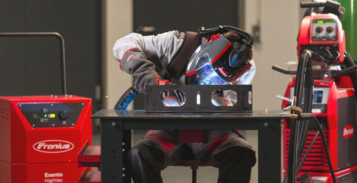

If, on the other hand, the welding process is perfected using arc length correction and joining is done with a fume extraction torch such as our MTW 500i Exento used with our Exento HighVac extraction system, then up to 99% of welding fumes can be extracted.
MAG welding with the MTW 500i fume extraction torch and HighVac extraction system, both Exento, and Fronius Vizor Air/3X Connect welding helmet
What’s more, our welding helmets with air-purifying respirator are the icing on the cake when it comes to protection against welding fumes. They filter a whole 99.8% of the remaining welding fume particles from the air. If welding specialists comply with all possible protective measures, welding is not only an exciting profession, but now also quite a safe one.
MMA welding with Fronius Vizor 4000 Air/3X with air-purifying respirator
