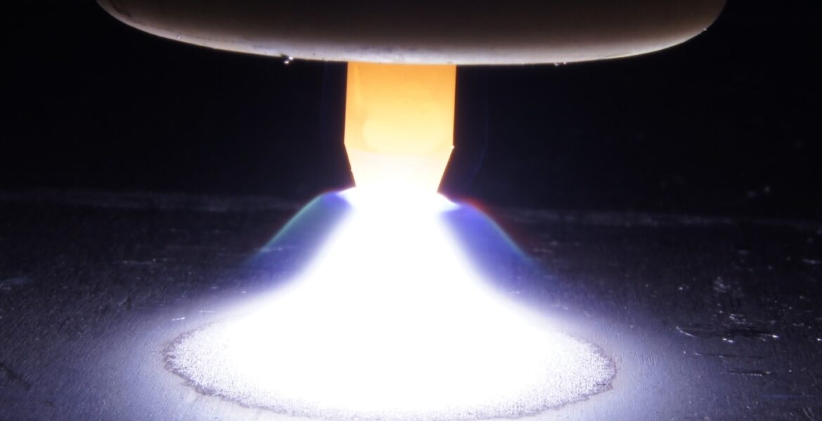

TIG arc between tungsten electrode and workpiece

TIG welding is a process that enables top-quality weld seams. The arc burns between a temperature-resistant, non-melting tungsten electrode, and the workpiece. The inert shielding gas that gives the process its name creates an oxygen-free gas atmosphere and prevents chemical reactions with the liquid weld pool. This results in smooth, level, and non-porous weld seams. The filler metal is guided manually or using a wirefeeder.

The tungsten electrode is at the core of TIG welding. At 3380 degrees Celsius, tungsten has the highest melting point of any pure metal in the periodic table. This means the electrode can emit an arc that heats and liquefies the workpiece without itself melting away.
