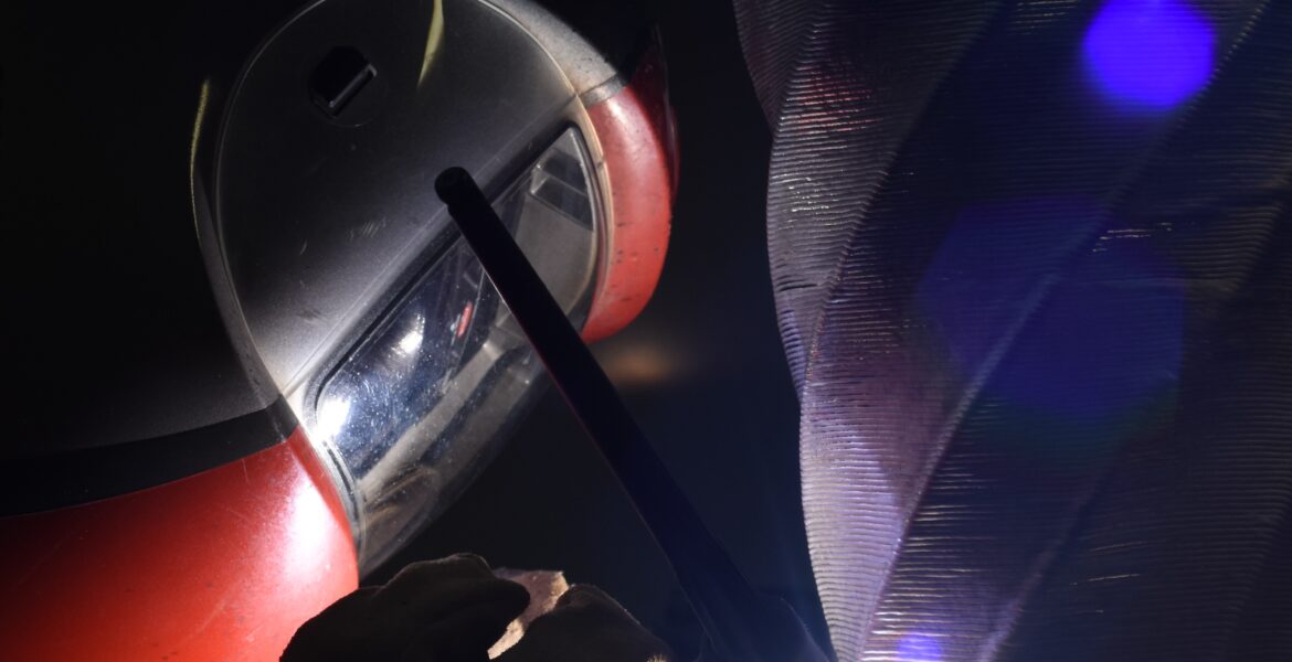

Welders carrying out TIG aluminum welding

It takes some practice to weld such an even TIG seam
When welding using alternating current (AC), the electrode continues to change from plus to minus. When the electrode is set to positive, the negatively polarized electrons move from the workpiece into the electrode, rupturing the oxide layer in the process. The electrode is then set to negative and the electrons moving into the workpiece generate heat—this is how the penetration required for the weld seam occurs.
