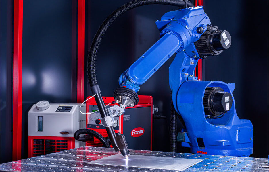

How hot active plasma works
The precise way in which this process works is derived from arc welding technology: the un-transferred arc is ignited in the welding torch between the electrode and plasma nozzle. This means that a ground earth connection to the part is not necessary. The arc is then purged out of the nozzle with process gas. Finally, the resulting plasma flame cleans or activates the part surface with pinpoint accuracy, with mechanical, thermal, and chemical processes being responsible for this.
The plasma flame can also be precisely adjusted to the respective material surface using various process settings. For plastic surfaces, for example, the heat must be reduced significantly. This is achieved predominantly using process parameters such as treatment speed, distance to the surface, amperage, and gas regulation.

Hot active plasma technology at Fronius
Have these versatile and fascinating process characteristics sparked your interest? With ACERIOS, we at Fronius have succeeded in developing a robot-controlled solution for plasma cleaning based on arc technology. The system can be perfectly integrated into a wide range of production processes. Intrigued? You can find out more about HAP technology from Fronius here.
