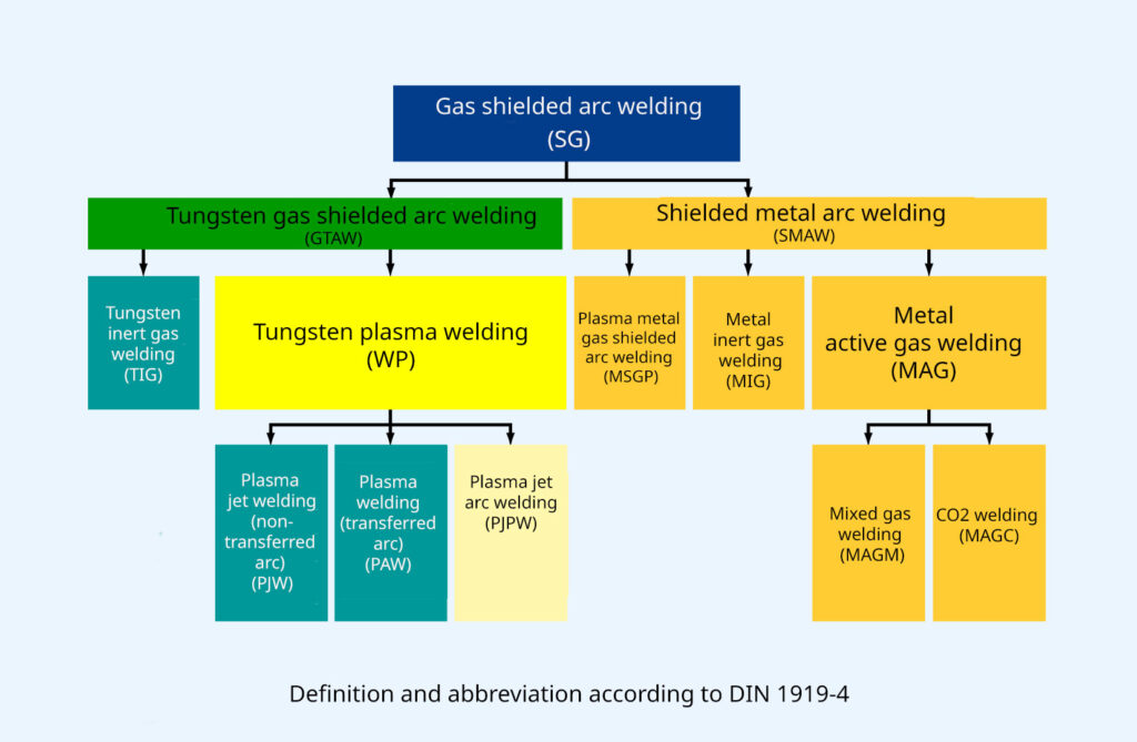

Definition of types of gas shielded arc welding
MIG/MAG – The most widely used process in the field of gas shielded arc welding
The MIG and MAG processes are also referred to as gas-shielded metal arc welding (GMAW). The welding wire here serves as both an energy source and filler metal at the same time. When it comes into contact with the base material during dip-transfer welding, a short circuit arises that causes both the base material and the wire electrode to melt and a material transfer occurs. Unwound from a wirespool, the welding wire is now continuously conveyed.
However, it must be clear from the outset which material is to be welded:
  • Steel = MAG. Active shielding gases are used here, which is why we also speak of metal active gas welding (MAG).
  • Aluminium and other non-ferrous metals = MIG. Inert shielding gases are used here, hence the name metal inert gas welding (MIG).
Whether MIG or MAG – depending on which process is ultimately required – the gas shielded arc welding system is optimally adjusted (parameterized) to suit active or inert gas, ensuring the best possible welding result is always achieved with both MIG and MAG welding.
