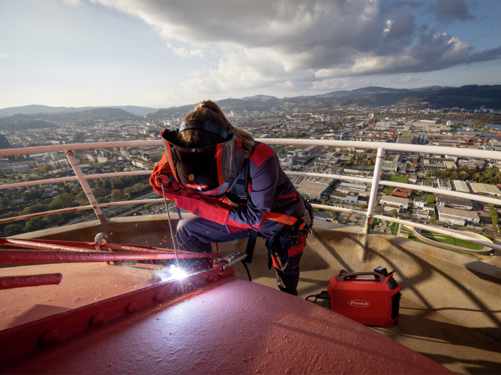

Welding environment
The choice of welding process depends on environmental influences. Is the component exposed to wind and weather or can it be welded while protected from these? TIG and MIG/MAG processes require a protective gas shield provided by a separately supplied gas. This can only be guaranteed in enclosed spaces or by sheltering the component so that the supplied gas cannot be blown away. When welding outdoors, it is better to use the manual metal arc welding method. The burning coating forms shielding gases and slag which protect the melt from chemical reactions with the ambient air.

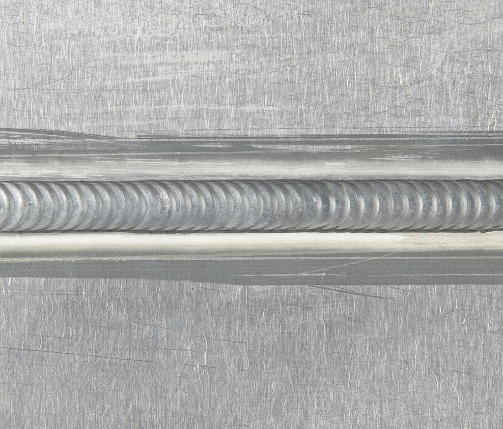

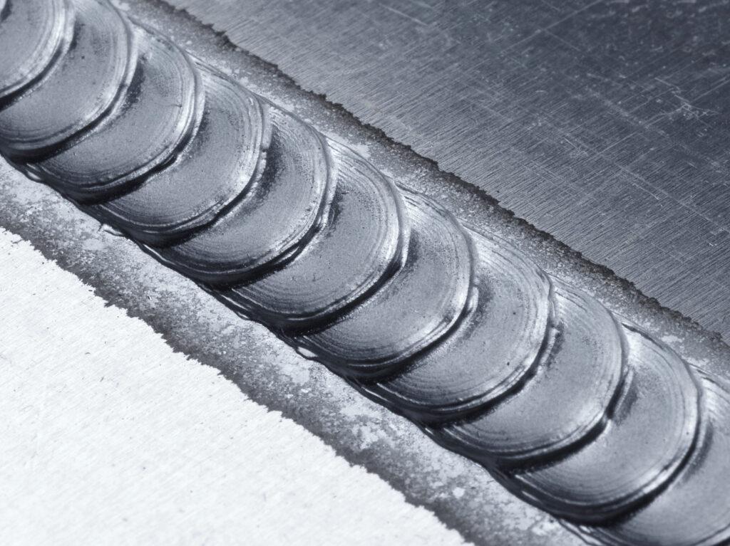

Seam optics
With visible seams, a flawless appearance is vital. A smoothly rippled seam appearance with an extremely fine texture is often required. This can only be achieved with the TIG process or by using special functions of the MIG/MAG process, such as MIG/MAG stitch welding or CMT. In manual metal arc welding, or stick welding, seam appearance depends on the type of electrode used.

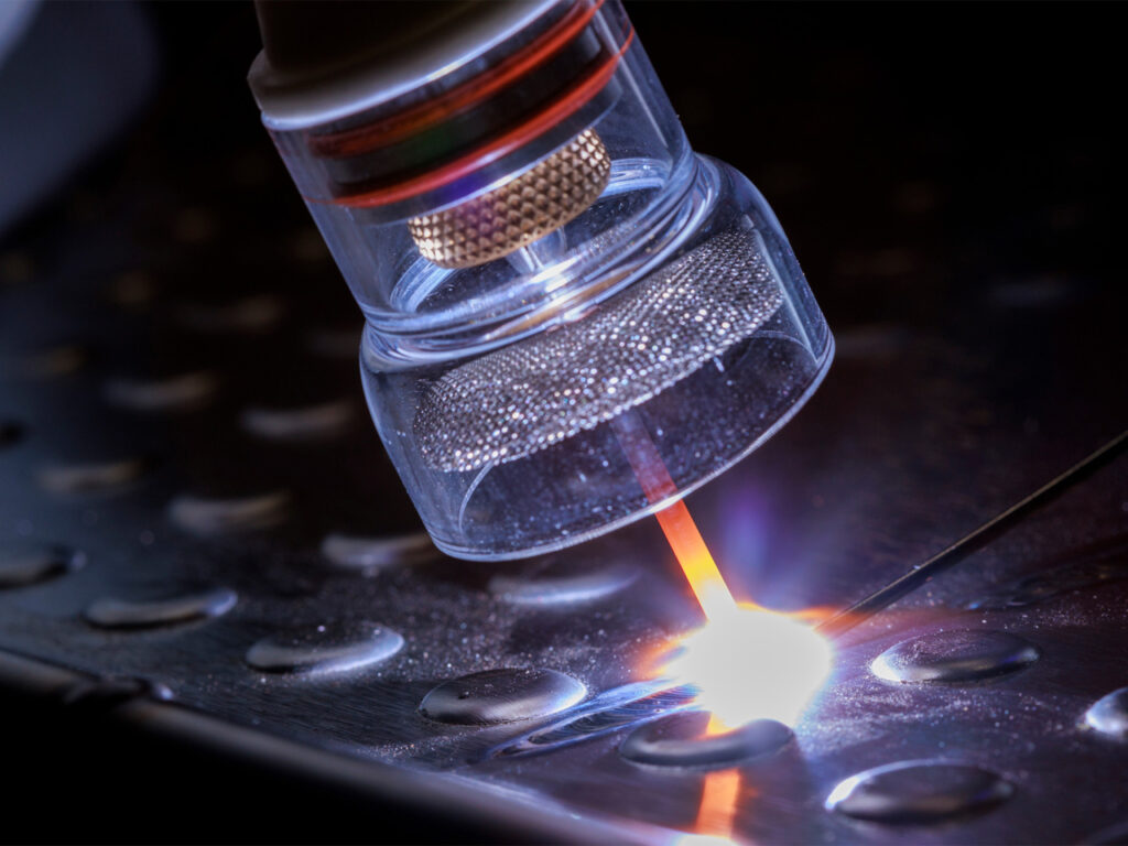

Seam quality
Where seam purity is paramount, TIG is the first choice. TIG weld seams have the best mechanical properties. MIG/MAG seams can also achieve very high quality.
However, high-quality TIG seams demand high purity of the joint edges prior to welding. They must be perfectly clean, i.e., free of rust, oil, grease, and any other impurities, in order to use the TIG process.
