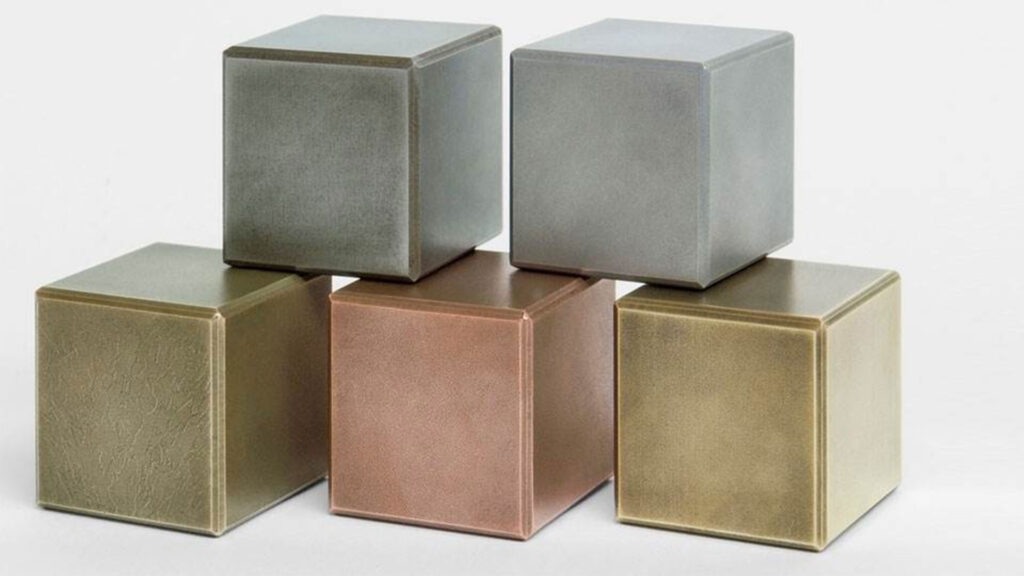

Long before it becomes a question of what welding machine settings need to be applied, it is necessary to identify the metal the workpiece is made of—the basis for all further steps. In most cases, the welder is of course aware of the material in question. If not, some test methods will help:
  • Visual impression: The trained eye can see at first glance whether the material is steel, stainless steel, aluminum, or another metal. The color is a particular giveaway. Dull, dark gray indicates a high iron content. Bright and sparkling suggests chrome-nickel alloys.
  • Magnet test: In case of doubt, a magnet can help to identify the material. Only steel, nickel, and cobalt are magnetic at room temperature. If the material is strongly attracted to the magnet, it is usually iron or low-alloy steel. If there is a weak attraction between the material and the magnet, it is probably alloyed stainless steel. Aluminum is not magnetic.
  • Oxidation: If the workpiece has formed rust spots, it is steel. Stainless steels, also known as chrome steel and aluminum, do not rust.
  • Weight: This criterion is particularly relevant with regard to aluminum. Steel has a much higher density than aluminum, and the same size of material is therefore about three times as heavy.
