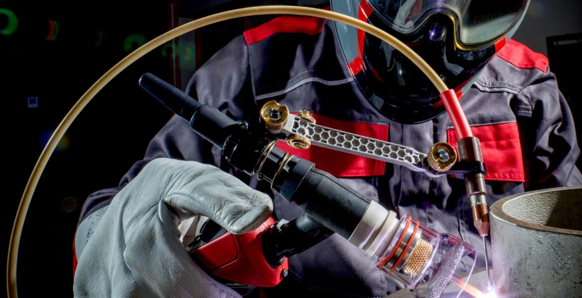

Dynamic wire control technology automatically selects the right wire speed based on the voltage between the arc and the workpiece. That means it adapts to the welder—not the other way around! To be more precise: The secret behind this new wire feed technology is that it automatically self-regulates. The welding system actively adjusts the wire speed to the welding behavior, torch position, and current conditions, even automatically compensating for component tolerances of up to 30%—for a 10 mm sheet that would be 3 mm!
Precise and User-Friendly
The name of this innovative new cold-wire welding process is TIG DynamicWire. In addition to offering a new process control function, TIG DynamicWire also impresses with its improved user experience. Great care was taken during the development process to ensure that all welders can work easily and comfortably, with as few steps and adjustments as possible. Once set up, the wirefeeder remains in a stable position. The aluminum holder, created using 3D printing, is also lightweight, ergonomic, and offers the user fantastic flexibility. And gone are the annoying vibrations through the torch handle, as—unlike with comparable solutions—the mechanical forward and backward motion of the wire has been dispensed with entirely with TIG DynamicWire.
Reduced Wear and the Perfect Weld
Faced with a shortage of professional welders, the iWave TIG welding system and its smart wirefeeder control TIG DynamicWire offer the perfect solution, allowing inexperienced welders to achieve good-quality welding results relatively quickly. The active adjustment of the wire speed compensates for any deviations, keeps welders safe, and ultimately delivers high-quality welds. What’s more, because the wire is not continually being moved forwards and backwards, wear parts such as the torch body, torch cap, and clamping sleeve last longer than comparable solutions.
