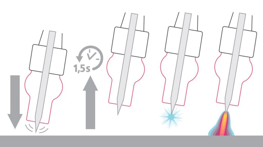

High frequency ignition (HF) is generally used for TIG welding. This produces an arc between the workpiece and the electrode without touching the workpiece with the electrode. For this purpose, the welding torch is positioned about two millimeters above the workpiece. If the welding torch trigger is then pressed, the arc ignites. As an alternative, touchdown ignition is recommended: The arc is ignited when the electrode touches the workpiece. However, there is a risk that the weld pool will be contaminated by the inclusions of the tungsten electrode. This is a serious shortcoming, particularly in sensitive welding tasks such as in medical technology.
Touch HF is the best way to easily and accurately position the ignition. The procedure for the welder is basically the same as for touchdown ignition: The workpiece is touched with the electrode. After lifting it off, the pre-set lead time starts. The arc then ignites exactly at the point where the electrode touched the workpiece. No other process offers better control during ignition.
The Touch HF function allows for the use of welding torches without trigger and is extremely useful for difficult-to-access interfaces such as small pipes.
There are welding systems that can switch between HF and Touch HF ignition as standard. The optimum ignition can therefore be selected depending on the application.

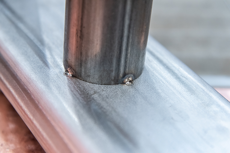

2. Tacking function (TAC)
TAC stands for “tacking,” meaning to attach. If two different components are to be joined to a workpiece, they must first be fixed in preparation. The weld pool is oscillated by means of a pulse current. This makes it easier to tack components together without burning the edges. If TAC is used in spot welding mode, it is always possible to achieve the same size tacking points. The uniformity of the welding spots makes welding over in particular much easier. Another advantage of TAC is that the tacking function allows for low, or in the best case scenario no temper coloration, and also achieves time savings of up to 50% compared to conventional tacking.

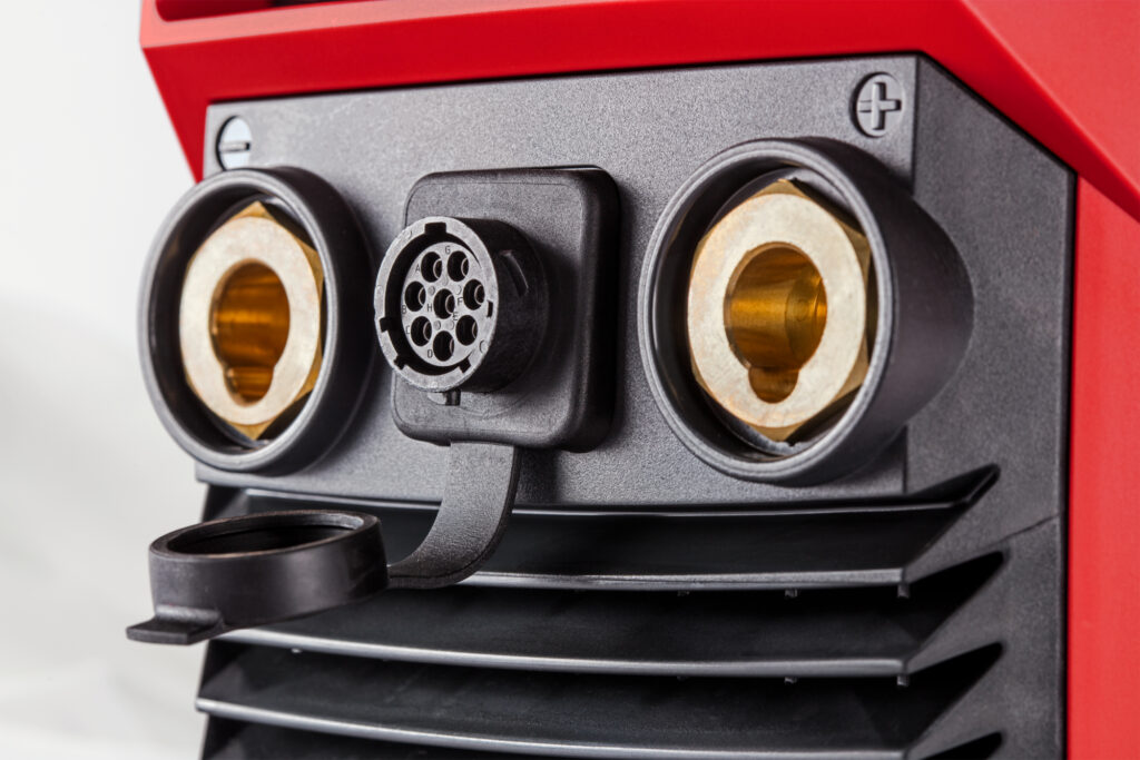

5. TIG Multi Connector (TMC)
The TIG Multi Connector is a universal connection, or a standardized interface. It enables control of the welding system by means of remote controls and welding torches with all additional functions, such as the Up/Down function.
