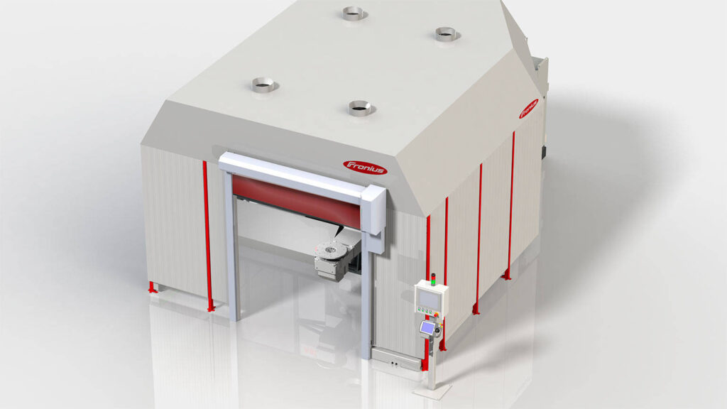

The best way to shield the arc during automated welding is in welding cells. These systems are equipped with enclosures that keep 100% of the arc radiation away from the welding personnel.
It is of course equally important to protect people in the vicinity of welding work from reflections and glare. That is why every welding workplace must be equipped with visual screening, for example in the form of red lamellar welding curtains. Such curtains absorb a large part of the radiation and, depending on the degree of coloration, even allow visual contact.
Fronius Robotic Welding Cell featuring complete enclosure and welding fume extraction

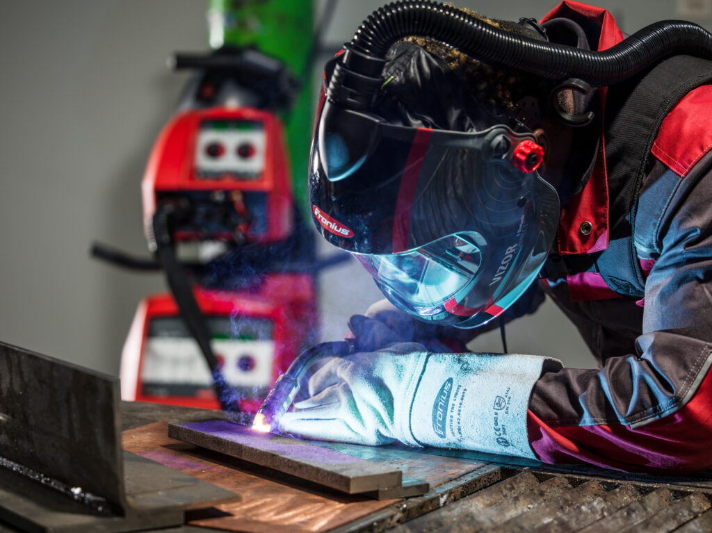

Besides completely shielding the arc (e.g. through cobot welding cells), using PPE is the most suitable measure to effectively protect yourself from arc radiation. Personal protective equipment against UV/IR radiation usually consists of welding helmets, protective goggles, welding apparel and protective gloves.
Welding Helmets
They protect the eyes from harmful rays and prevent eye conditions such as cataracts or conjunctivitis. They are available in various designs that protect not only the face, but also the head and neck. Depending on the type of welding and the protection requirements, you can find a variety of welding helmets on the market.
Passive welding helmets have a built-in protective filter that protects against radiation. With these helmets, it is not possible to adjust the level of darkening, so users have to lift the helmet before and after welding.
Automatic welding helmets feature an automatic darkening system that activates the protective filter at the start of the welding process, providing protection against glare. The darkening takes place within fractions of a second and is usually seamlessly adjustable.
Some of these high-quality helmets incorporate special UV/IR filters that use specialized technologies to block all harmful rays while allowing the harmless visible light to pass through with the best possible transmission. This results in a highly detailed color reproduction that even allows users to see the melting process, ensuring the highest possible welding performance.
The latest generation of innovative helmets are equipped with Bluetooth® technology. They activate immediately before the arc is ignited, at the welding system’s command.
Fronius Vizor Connect automatic welding helmet with Bluetooth® technology
All in all, welding helmets provide vital protection against glare, radiation and flying sparks.
