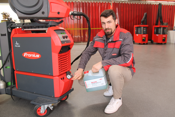

3) No Water, No Cola: Use the Correct Coolant
Using the right coolant is crucial for the service life of a welding system’s cooling system. In principle, only coolants recommended by the manufacturer should be used. It is better to avoid improvising with dubious alternatives, which can range from demineralized water to cola.
But why does using the wrong coolant shorten the service life of the welding system, and why might something seemingly innocuous like pure water cause damage?
Cooling water in general: Essentially, you should avoid using any type of water as a coolant, because the particles, salts, and mineral molecules contained in the water cause pipes and seals to corrode in the long term.
Hard tap water—condensed water: The use of water above a certain degree of hardness causes the pipes the heated cooling water flows through to slowly clog up due to lime or calcium carbonate deposits. In welding systems, increasing calcification of the pipes has a negative effect on the circulation of cooling water and thus on the cooling process.
Algae formation: When tap water is used, algae can also eventually form in the tank. Algae formation is usually noticeable due to a greasy film that forms over time on the bottom and on the walls of the tank. In the cooling circuit, these deposits can damage the cooling system pump, as well as other components.
Good coolants for welding systems have the following characteristics:
  • Protection against corrosion
  • Incombustible
  • Frost-proof (in Central Europe up to min. –10 degrees)
  • Environmentally friendly disposal
The use of suitable coolants has a decisive impact on the service life of liquid-cooled welding systems.

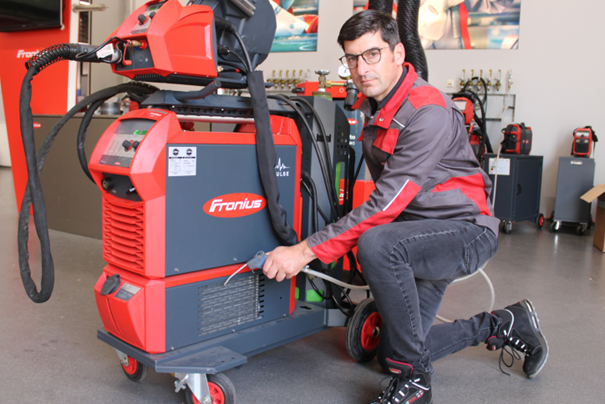

4) Check Pump Function
The coolant pump is the central element of any cooling system that works with liquid. It therefore makes sense to regularly check that this key part is working properly. A faulty cooling circuit or a malfunctioning pump can significantly affect the service life of welding systems, especially since heat that is not dissipated attacks the entire system.
It is easy to check whether the cooling circuit of the welding system is working by checking whether the pump is functional and generating enough return flow. To do this, unplug the return line and run water into a bucket for one minute. If there are at least 1.5 liters in the bucket, the system is functional. At the same time, you should determine whether there is sufficient coolant, especially as running a pump dry can often irreparably damage it.

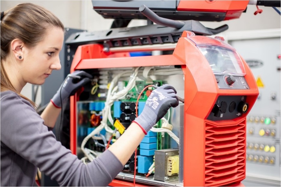

6) Blow Out: Remove Dust from the Welding System
Excess dust can negatively affect the functionality of mechanical and electronic components in the welding system in the long term, thus affecting the service life of the entire system.
Compressed air is the weapon of choice in the fight against dust. In most cases, it is sufficient to remove dust from the cooling fins of the welding system at regular intervals using air from the compressor to ensure continuous ventilation.
At least once a year, though, appropriately trained and qualified personnel, such as company electricians, should open the welding system and also blow out the interiors. It is particularly advisable to proceed with caution when it comes to delicate components, such as printed circuit boards. The compressed air jet should never be directed at sensitive parts at close range.
Too much dust can negatively affect the functionality of mechanical and electronic components in the welding system in the long term, which is why the interiors should be blown out regularly.
