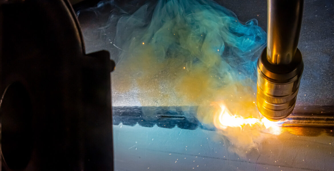

LaserHybrid welding under the microscope
LaserHybrid welding combines a high-energy laser beam with the metal shielding gas process (MSG process). The combination of electric arc and laser-induced plasma facilitates precise, controlled heat input into a single weld pool. In most cases, this involves a pulsed arc (PMC) or an arc with reversing wire motion (CMT).
The combined use of both joining technologies in this process leads to a significantly high welding penetration depth, high welding speeds, and excellent joining tolerance compensation. “The reduced heat input favors the formation of highly resilient and durable connections, making the process ideal for safety-relevant structures,” adds Johannes Gaisberger.
Targeted process control, in particular in conjunction with the CMT process, also allows a considerable reduction in the heat-affected zone, which means that the mechanical properties of the welded joint are largely retained compared to the base material.
