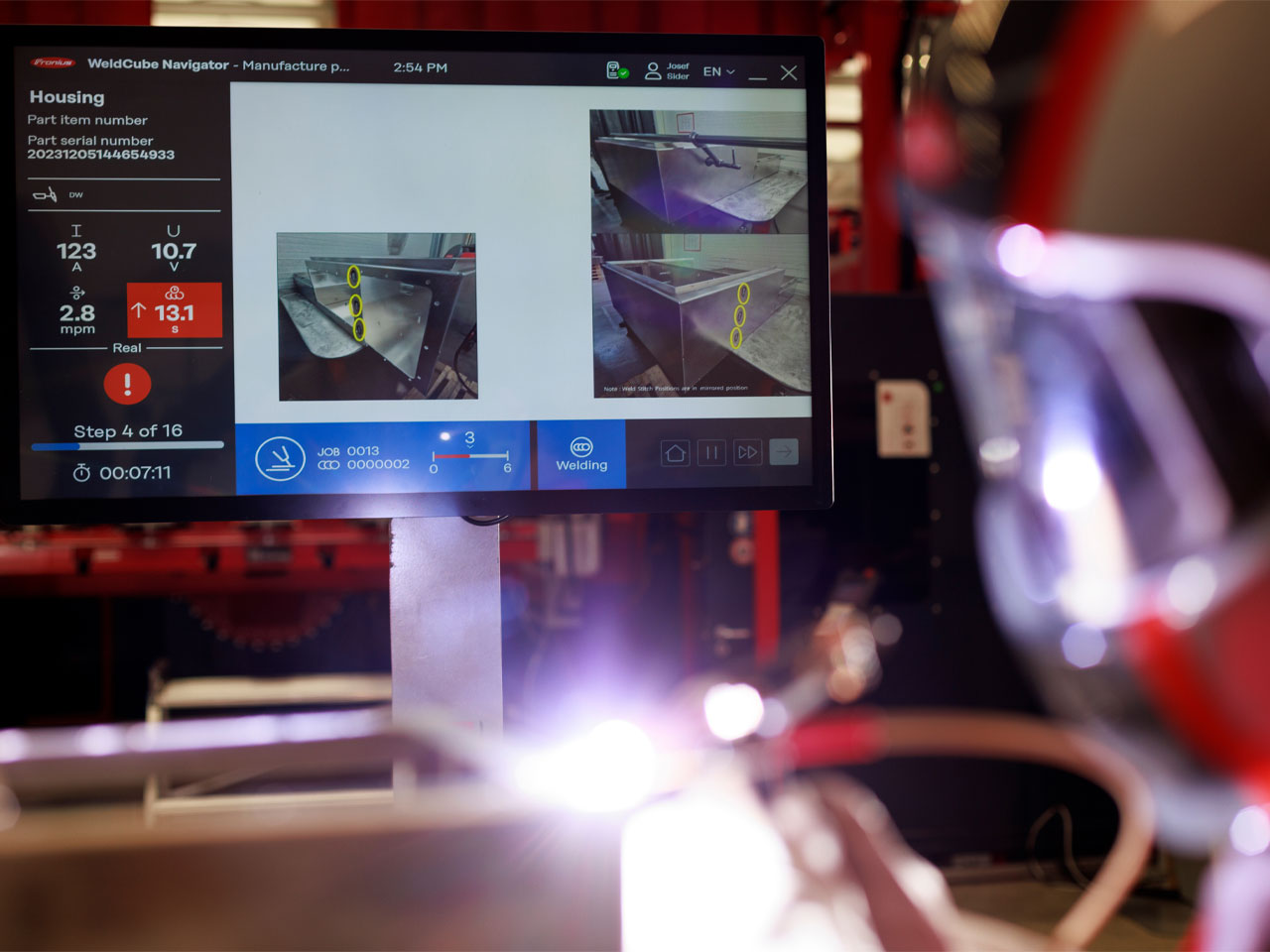

What is it like to use weld sequencing? Welders basically stand at the work station and let the software show them what to do next. An additional screen shows each production work step visually in the correct order and the parameters are automatically set on the welding system. Workers are steadily guided through their tasks and it is easy to follow the correct welding sequence and ensure that the defined parameters are also used for each weld.
Workers also receive feedback on their welds and can monitor their progress. If an error occurs, the welding system can automatically lock itself and welding can only continue once the error has been cleared by the welding coordinator (optional). This early intervention can ultimately save companies time and money.

An example of digital weld sequencing comes in the form of the Fronius WeldCube Navigator: a software which supports welders during production and combines all the aforementioned advantages of weld sequencing.

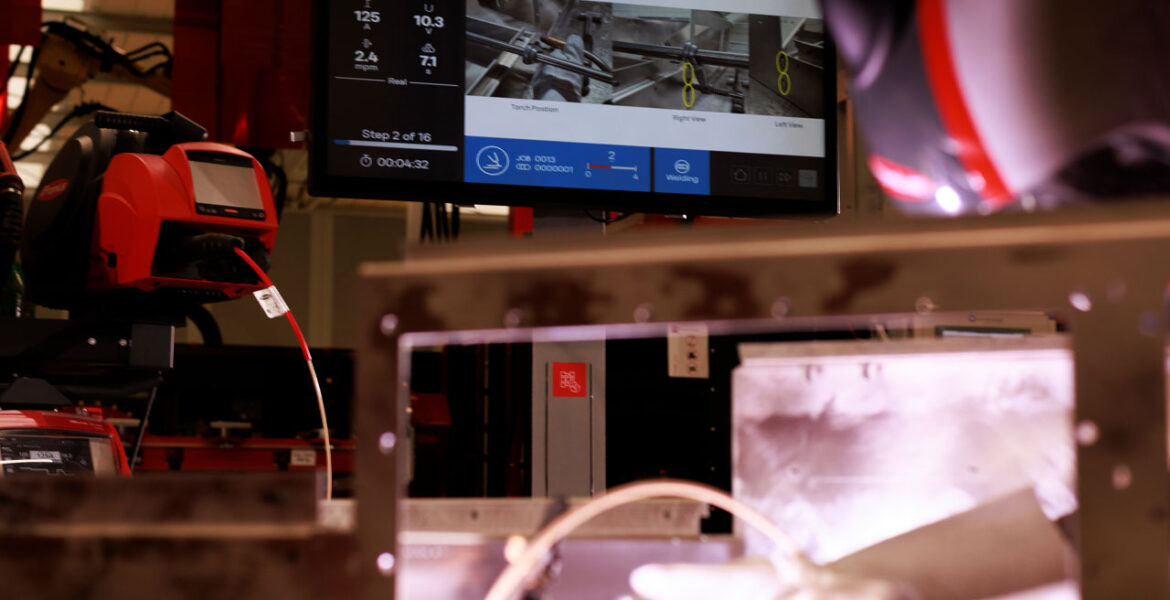

Two key elements of the software are the sequencer and the editor. The sequencer guides the worker through all welding tasks via an appropriate screen in the welding cell and the output is monitored in regard to the permitted number of welds. What is particularly practical is that the welder can operate the WeldCube Navigator throughout with the welding torch. Selecting instructions, switching to the next job, and confirming can all be done with ease from the torch itself!
The editor digitizes and visualizes instructions for production. It can create and save digital work instructions for manual welding production. For example, individual images for each work step can be uploaded with the necessary information for the welder. Special instructions can also be defined, such as the number of permitted welds, the welding job to be used, and the response in the event of an error. This provides maximum flexibility in terms of design and conveying information!
