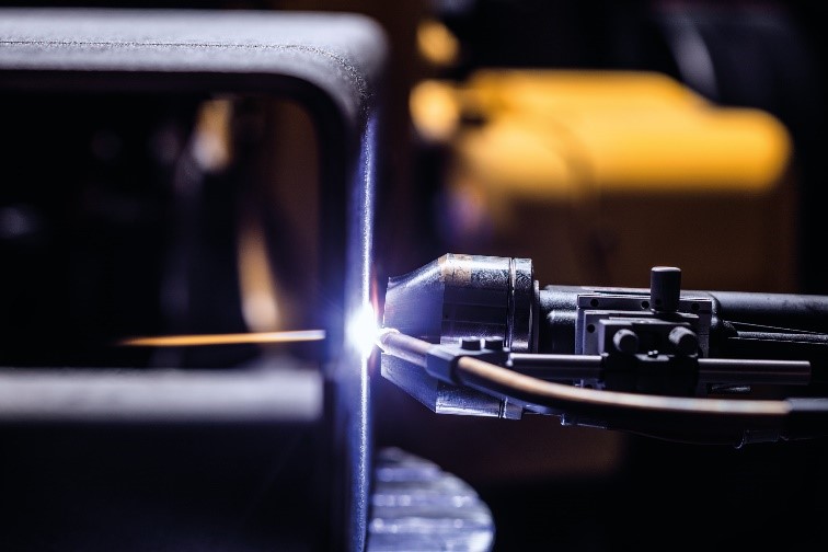

Image title: Plasma longitudinal welding with a seam welder
Plasma circumferential welding with carrier gas device
Function and advantages of plasma weldig
In welding technology, plasma welding is a process whereby the arc is constricted by plasma gas. This creates a concentrated, almost cylindrical arc, which changes according to the plasma nozzle diameter and the amount of plasma gas used. The plasma jet itself consists of an accelerated, ionized gas jet and is passed through a special plasma nozzle.
TIG arc (temperatures up to 15000°C) vs PLASMA arc (temperatures up to 30000°C):
The high pressure of the plasma forms what is known as a keyhole at the start of the seam, whereby the parent material is melted through its entire depth. This makes it possible to weld high-alloy chrome-nickel materials with wall thicknesses of up to 10 mm using square butt joints. A cold wire is generally used to fill up the keyhole and counteract root sag. Single-pass welding without pre-processing is possible up to a material thickness of eight millimeters.
