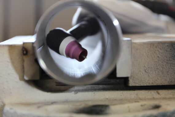

For all TIG-joined stainless steel sheets, it is therefore important – especially in the food and drinks industry – to protect the sensitive oxide layer. However, for root passes in particular, and above all in container and pipeline construction, not only the weld seam surface but also the underside of the root must be suitably protected. Forming gas is used here, similar to shielding gas from the welding torch on the weld seam surface.
Forming in pipeline and container construction
Forming is an indispensable process in the food and drinks industry to prevent corrosion on the underside of the root. The forming gases used , for example Nitrogen (N2), Argon (Ar), or Argon-Hydrogen(H2) mixtures, displace (similar to the shielding gas from the welding torch on the top of the root) the atmospheric oxygen in the welding area. In addition, the shape of the root underside is optimized during welding, as it is formed much more smoothly and is virtually flawless, which saves a lot of rework. This ensures that pipes, containers, and storage containers – for example for breweries – end up with precisely manufactured, ultra-pure surfaces on the inside too.
In pipeline construction, the forming gases are often flushed through the whole workpiece or through the corresponding section of the circumferential weld being welded. For this purpose, special forming gas devices made of silicone are used that virtually seal off the pipe in order to fill the space with gas.
Similarly, in container construction or for pipes with larger diameters, trailing gas nozzles are used, which also flush the gas around the underside of the weld seam, but without having to completely fill the whole workpiece. It should be noted that even after the welding process is over, the forming process continues until the parent material has cooled down to below 200 °C (varies depending on the material).

The quality criteria for the food and drinks industry clearly also apply to mechanized TIG welding: ultra-pure surfaces and clean, smooth seam structures are of critical importance. The circumferential welds produced must also be flawless and, above all, be 100% reproducible in mechanized applications. Among these automated welding systems, a rough distinction is made between systems in which the welding torch moves around the component and systems in which the torch is fixed but the component is turned.
Welding Automation from Fronius also offers various successful systems for this purpose. For example, the Fronius FCW Compact system is ideal for pipe welding with a fixed welding torch. By contrast, the Fronius orbital welding system  enables quick and easy pipe welding where the component is fixed and the welding torch can be moved.
