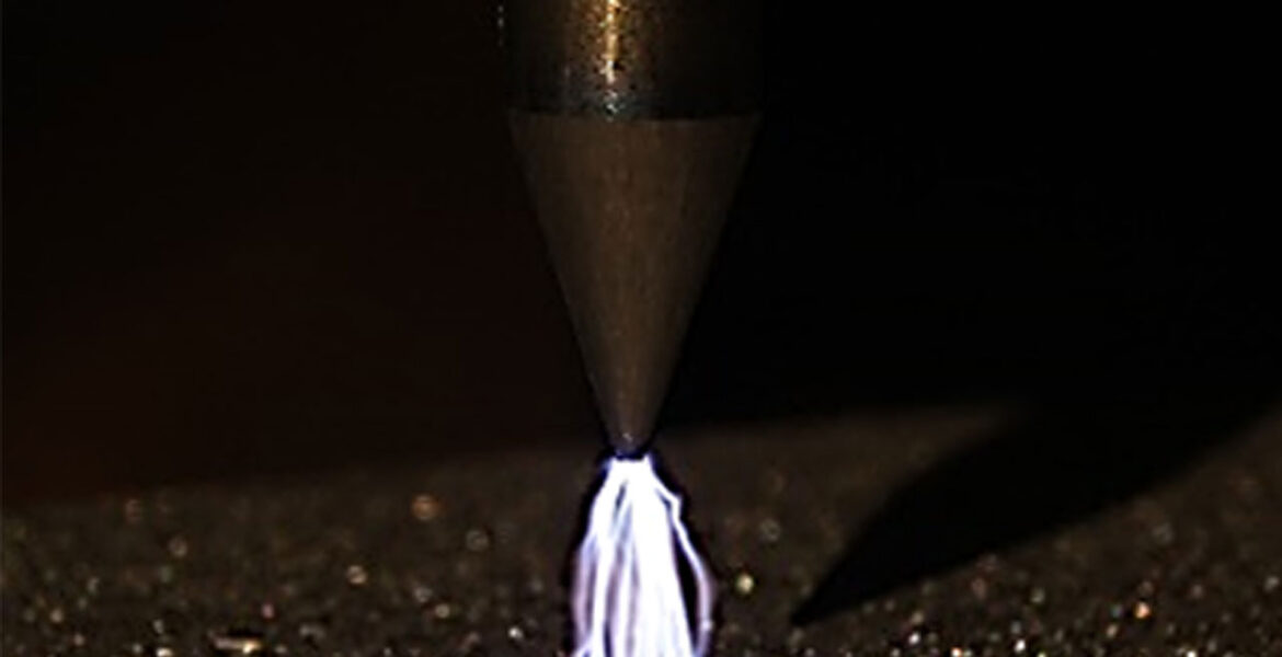

To rule out any inclusions in the parent material and ensure ultra-pure seam quality, high frequency (HF) high voltage (HV) ignition has been developed; usually known simply as HF ignition. In terms of quality, HF ignition is simply the best – weld seams do not get any better than this. Touchless, short circuit-free ignition of the TIG arc is only possible using this function.
The tungsten electrode is positioned roughly two millimeters above the desired welding start position. When the torch trigger is pressed, the contact-gap between the parent material and electrode tip is ionized through high voltage at roughly 11 kV. The arc can therefore ignite precisely at the desired point.
Standard HF ignition with torch trigger
Standard HF ignition as high-speed recording
