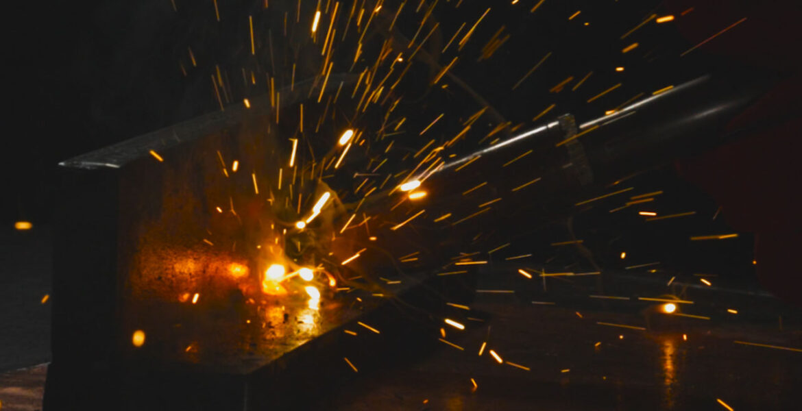

When the sparks start flying, welding spatter on the workpiece is usually not far behind. And once it’s there, it has to be removed – at the expense of both time and money. As prevention is better than cure, we need to do what we can to prevent welding spatter – or at the very least reduce it to a minimum. But how? Every welder has it in their power to help in the fight against spatter, be it by using the optimal welding equipment, preparing materials properly, handling the torch correctly, or by making minimal changes to the workplace. With these 8 tips, you too can declare war on welding spatter!

Welding spatter is the term for small droplets of metal that are sprayed out of the weld area by the power of the arc – usually landing on the workpiece, weld, or the wearing parts of the welding torch itself. In addition to lengthy and cost-intensive cleaning, weld spatter can also cause the following problems:
  • Poorer weld seam quality
  • Unclean and unsafe workplace
  • Production downtimes
For this reason, welding spatter needs to be prevented wherever possible. And with our quick tips, you’ll be ready for everything. Let’s start with the optimal welding equipment!

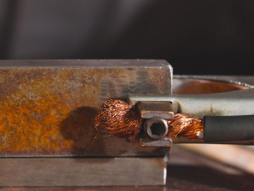

1. Ensure a constant current flow
A constant current flow is absolutely critical to preventing weld spatter. It is therefore essential that the welding torch and the return lead cable are securely connected to the power source. The same applies to the grounding on the component: the fastening point and earthing clamp must be bare and highly conductive to allow the current to flow.

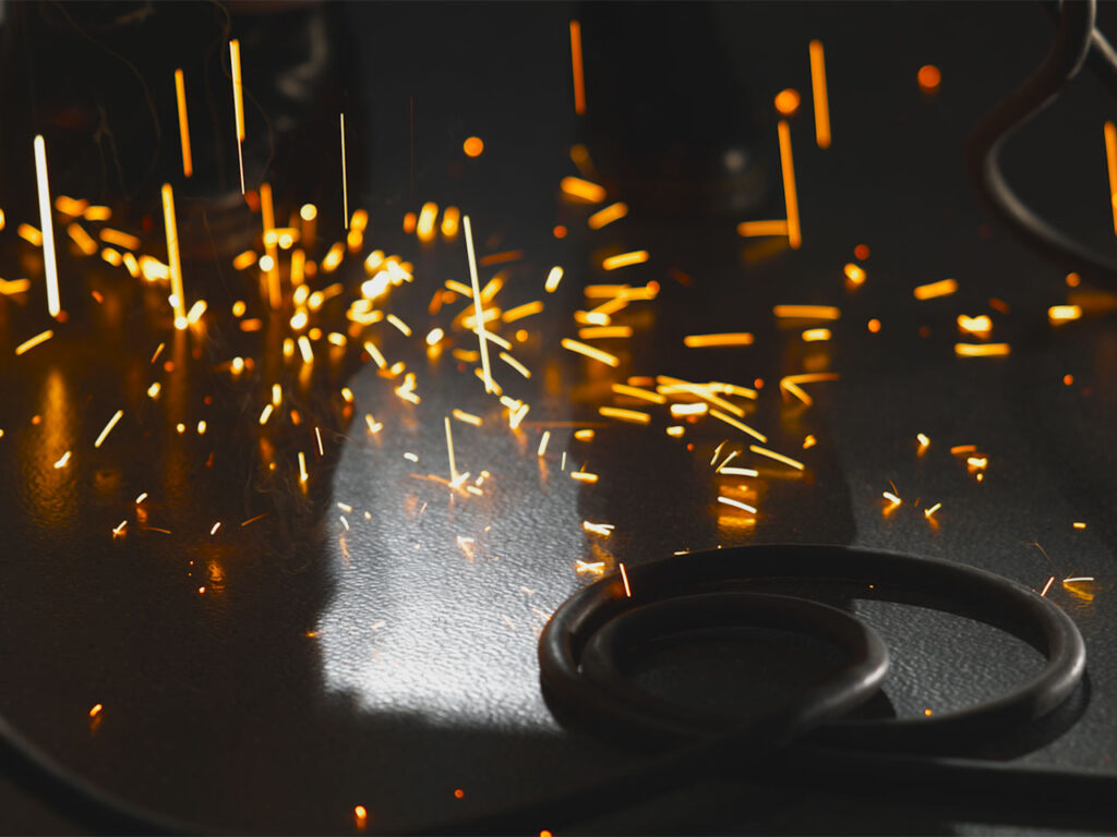

2. Ensure a constant wirefeed
For welding to be as low-spatter as possible, the arc has to be stable. And to have a stable arc, you need a constant wirefeed. To ensure this, three things are important:
  1. Ensure the welding torch is kitted out correctly (inner liner (diameter and length), inlet piece, etc.).

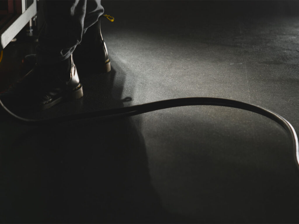

  2. Ensure as few bends as possible in the hosepack.
  3. Adjust the contact pressure at the wirefeeding rollers to the wire being used. “Too little pressure can allow the wire to slip through, causing a wirefeeding problem that can very quickly develop into a spatter problem,” explains expert welder Josef Sider.
Bends in the hosepack can cause a wirefeeding problem,
which in turn leads to a spatter problem
Doing it right:
laying out the hosepack without any bends
