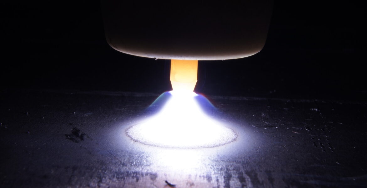

What is arc welding?
The temperature within the plasma column of the arc lies between 3,500 and 15,500 degrees centigrade; high enough to melt and join metal. An arc burns between the parent material and the electrode, which will have the opposite polarity.
In the case of gas metal arc welding (GMAW), the polarity of the wire electrode is positive while that of the parent material is negative.
In the TIG process, the current flows between a tungsten electrode with negative polarity and the workpiece with positive polarity.
