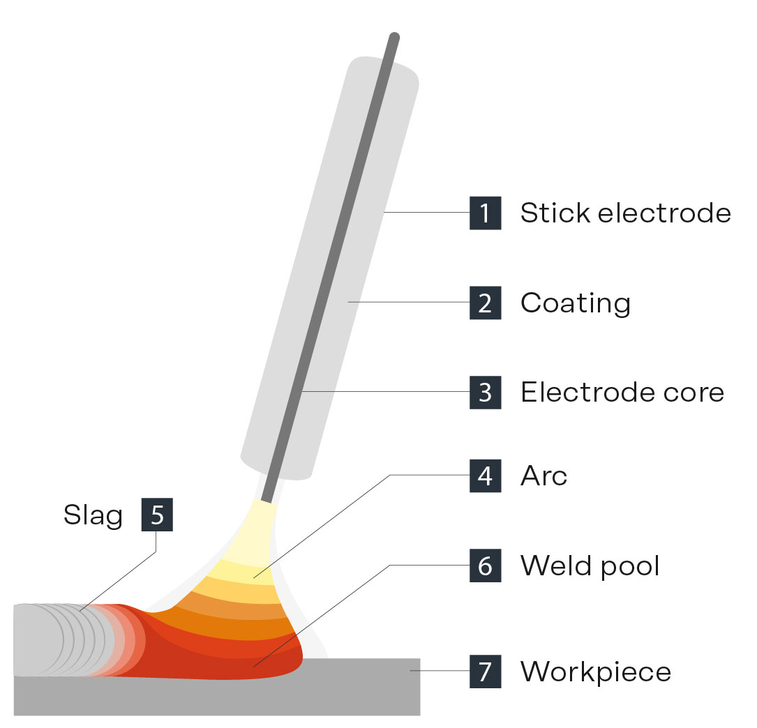

MMA welding
MMA welding goes by many names—manual metal arc welding, stick welding, or manual electrode welding. And the application scenarios are as diverse as its names. This welding method is relatively weather-resistant and is suitable for many metallic materials, particularly steel, stainless steel, and cast iron.
Visit our website to find out exactly how MMA welding works.
  • Application: Steel and pipe construction, building and infrastructure maintenance, shipbuilding, agricultural equipment repairs, underwater welding, and much more.
  • Material: Many metallic materials can be welded using a suitable stick electrode, including structural steel, stainless steel, and cast iron. Special materials require suitable electrodes and more experience.
  • Advantages: Easy to use, quiet, low initial costs, high-quality welds, not affected by weather conditions

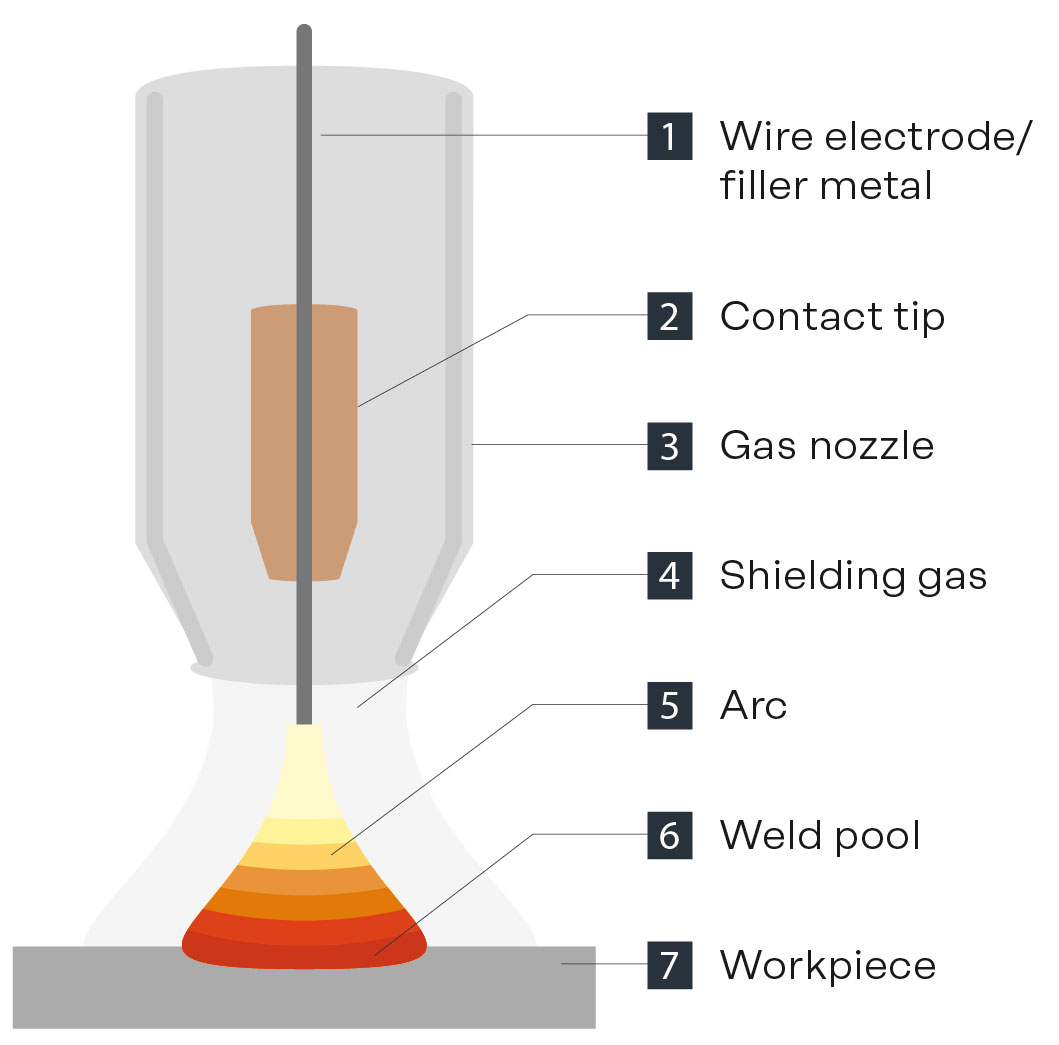

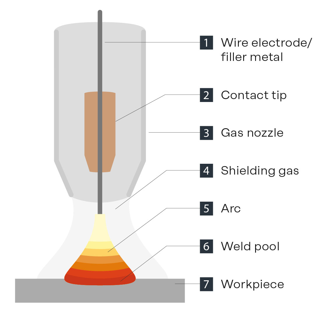

MIG/MAG welding
MIG and MAG count among the gas-shielded arc welding processes with a consumable wire electrode. MIG welding uses inert (chemically inactive) shielding gases while MAG welding uses active gases or active gas mixtures. The choice of shielding gas is heavily dependent on the material and the desired welding result.
Click here to find out how arc welding with a consumable electrode works and which gas is used.
  • Applications: Metalworking industry, steel, shipbuilding, and container construction, as well as the automotive industry
  • Material: Structural steel, stainless steel, aluminum, and aluminum alloys. Depending on the process and shielding gas, it can also be used to weld special materials such as copper, titanium, or nickel alloys.
  • Advantages: Easy to learn, high welding speed, high deposition rate, low filler metal costs, easy to ignite the arc

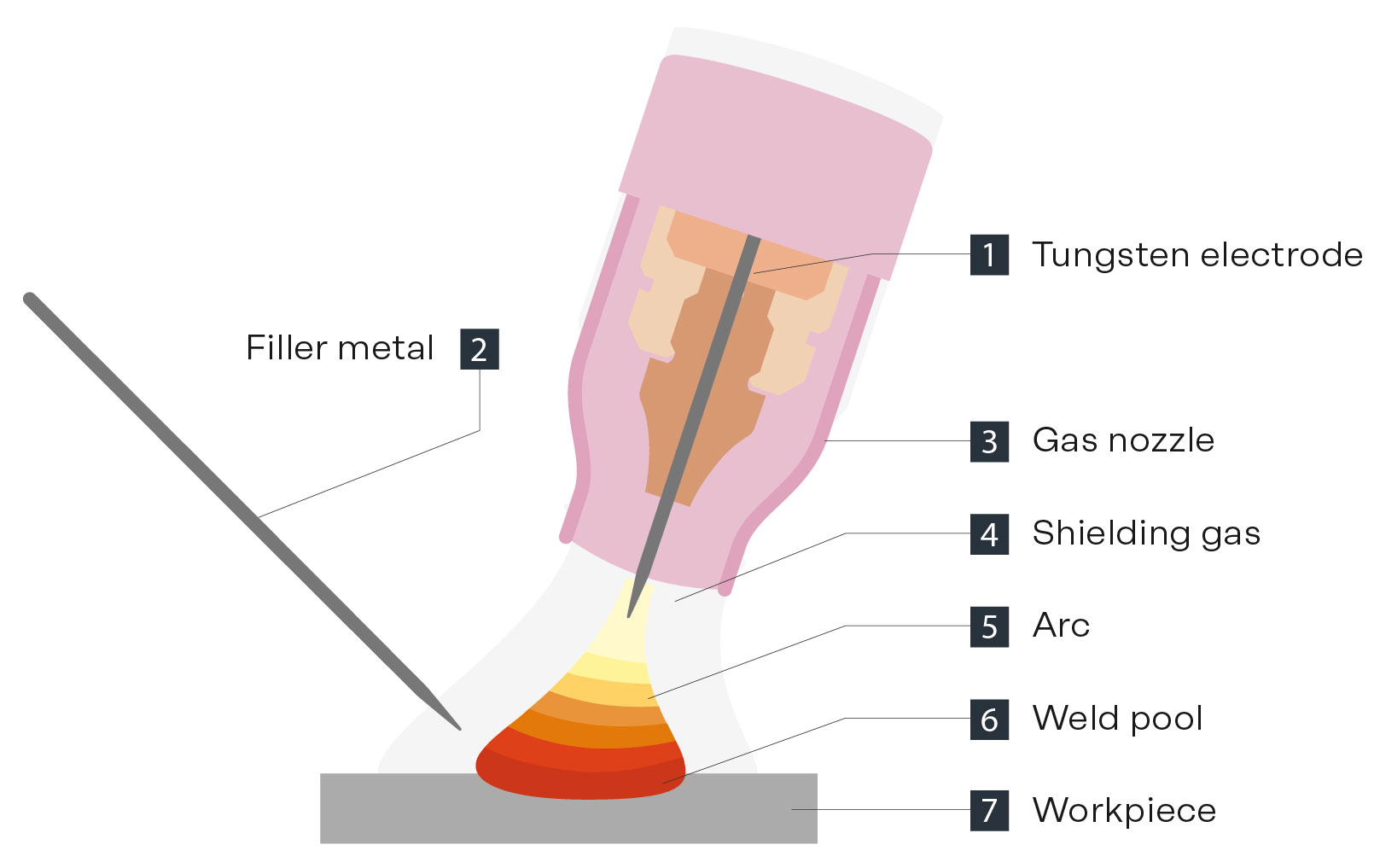

TIG welding
TIG welding is a fusion welding process that uses inert shielding gases. Welders need a high level of technical skill for this process, as the filler metal is usually added by hand.
We have summarized the most important details of the TIG welding process for you here.
  • Application: Pipeline and container construction, medical technology, aerospace, automotive industry
  • Material: Stainless steel, aluminum and nickel alloys, thin sheets of aluminum and stainless steel
  • Advantages: No welding spatter, high-quality weld seams (in both quality and appearance), can be performed in all welding positions, filler metal is not always necessary
