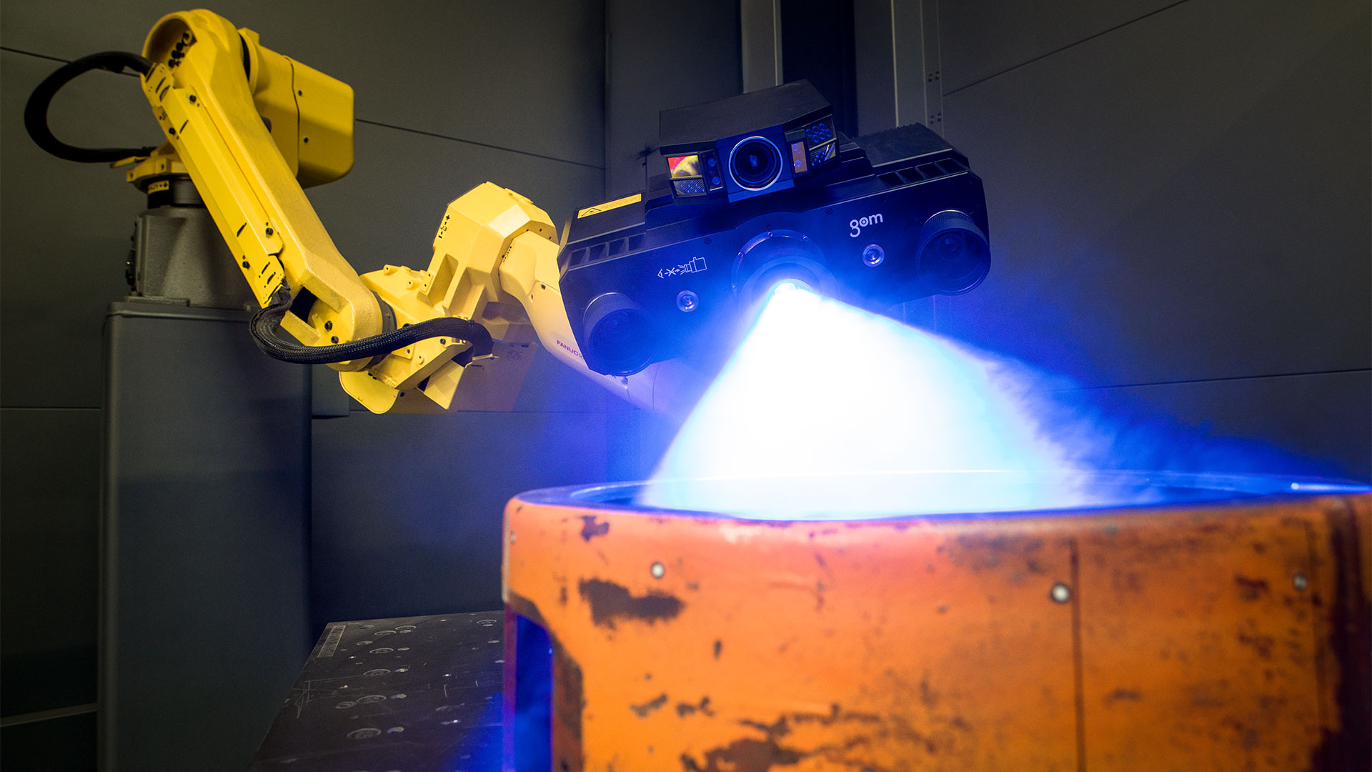

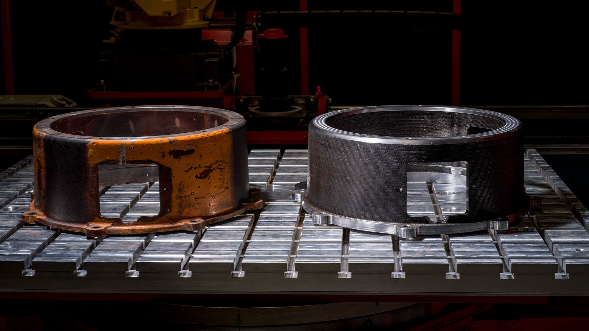

Repairs & reverse engineering with metal 3D printing
Reverse engineering in additive manufacturing involves analyzing an existing component and digitally modeling it in order to subsequently reproduce or make targeted improvements to it via metal 3D printing.
Reverse engineering process step-by-step
- Creating a 3D scan of the original component
- Reconstruction of the geometric data with an accuracy of up to one hundredth of a millimeter for a highly precise representation of the component
- Optional component optimization, such as weight reduction or reinforcement of weak points, is possible during reconstruction
- Additive manufacturing begins as soon as the model, component design, and parameters have been determined
- Finishing of functional surfaces by milling
The advantages of reverse engineering in combination with additive manufacturing are obvious, explains Oliver Pöpl, group leader of the Prototyping and Manufacturing Center: “This excellent flexibility is evident in the wide variety of materials and the topology-optimized design, allowing high-quality materials to be applied exactly where we want them.”
Another key financial advantage lies in the reduction in storage costs, with additive manufacturing permitting individual parts and small batches to be produced as needed. Although traditional methods such as casting can also be used to manufacture individual components, high tooling costs and long lead times generally make this uneconomical, especially for small production runs.
Instead of physically stocking components, digital component archiving makes the “recipe” reusable at any time—a digital spare parts inventory that saves costs and shortens delivery times.
Reverse engineering: from 3D scanning to additive manufacturing

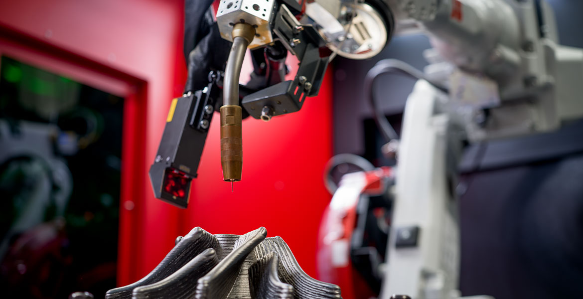

Why cold metal transfer (CMT) is ideal for metal 3D printing
Cold Metal Transfer (CMT) has proven particularly effective for metal 3D printing. The following overview shows how CMT differs from processes such as conventional dip transfer arc and why it is so effective.
What is cold metal transfer?
In order to achieve the desired quality with additive manufacturing, we need an extremely stable welding process like CMT. CMT is a “cool” dip transfer arc process that works at higher welding speeds compared to other methods while keeping the heat input low.
This is made possible by a reversing wire electrode motion that precisely controls the detachment of each individual droplet. The virtually spatter-free material transfer that results significantly reduces errors and rework. Depending on the characteristic for the filler metal, shielding gas, and electrode diameter, this wire movement takes place within a frequency range of 50 to 170 Hz.
CMT vs. conventional dip transfer arc
With conventional dip transfer arc processes (which are not especially suitable for WAAM), the wire moves continuously toward the workpiece. A short circuit occurs when the softened end of the wire touches the weld pool, causing most of the molten welding wire to transfer into the pool (the droplet detachment). During the short-circuit phase, the welding voltage approaches zero while the current rises sharply: the short circuit breaks and the arc reignites. With CMT, the droplet detachment and arc re-ignition are much more controlled and involve less energy input .
It is precisely these qualities that are decisive for additive manufacturing: the heat input generated during CMT welding is up to 33% lower than with a conventional dip transfer arc. This is particularly advantageous when cyclically building up weld beads, as this process generally results in a high heat input. If the component temperature is too high, the material properties are impaired to the point where the welding process would have to be interrupted until the weld layers have cooled.
“This is where CMT really shines. Thanks to the significantly reduced heat input and the extremely stable arc, identical weld layers can be built up and cooling times can be reduced without introducing unnecessary heat into the component. This makes CMT one of the most efficient and reliable technologies for many WAAM applications,” explains Manuel Stinglmayr, an expert in New Business Development Welding at Fronius International. Furthermore, fluctuations in the contact tube distance are not a major concern with CMT and the arc remains stable.
CMT Additive Pro: precise layer control for consistent metal 3D printing
The CMT Additive Pro functions specially developed by Fronius for additive manufacturing enable precise control of the heat input and thus the height and width of the weld seam.
- Power correction: Enables precise adjustment of the electrical power to the respective process phase (layer build-up and heat input) without changing the deposition rate.
- Deposition Stabilizer: Ensures that the arc-on time remains constant regardless of stick-out fluctuations, without losing the characteristic CMT stability.
- Pulsed HotStart: When resuming welding after changing the wire spool, for example, Pulsed HotStart achieves sufficient penetration during the pulsed arc so that the layer height remains constant and prevents fusion defects or humping.
- CTWD measurement: Provides users with real-time feedback on the exact position of the component and allows them to make the necessary corrections in the event of deviations from the planned position.
Together these features ensure a uniform, predictable layer build-up across the entire height of the component while reducing scrap and rework in the additive manufacturing process.

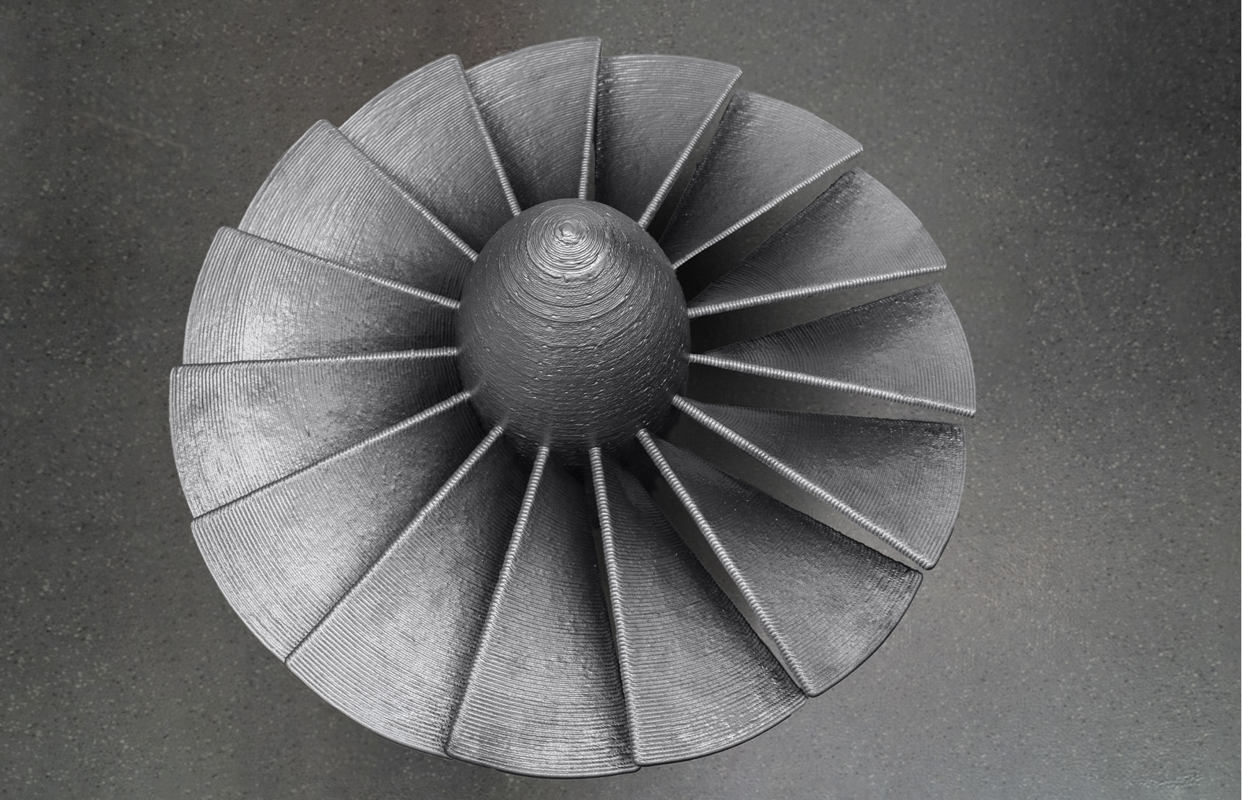

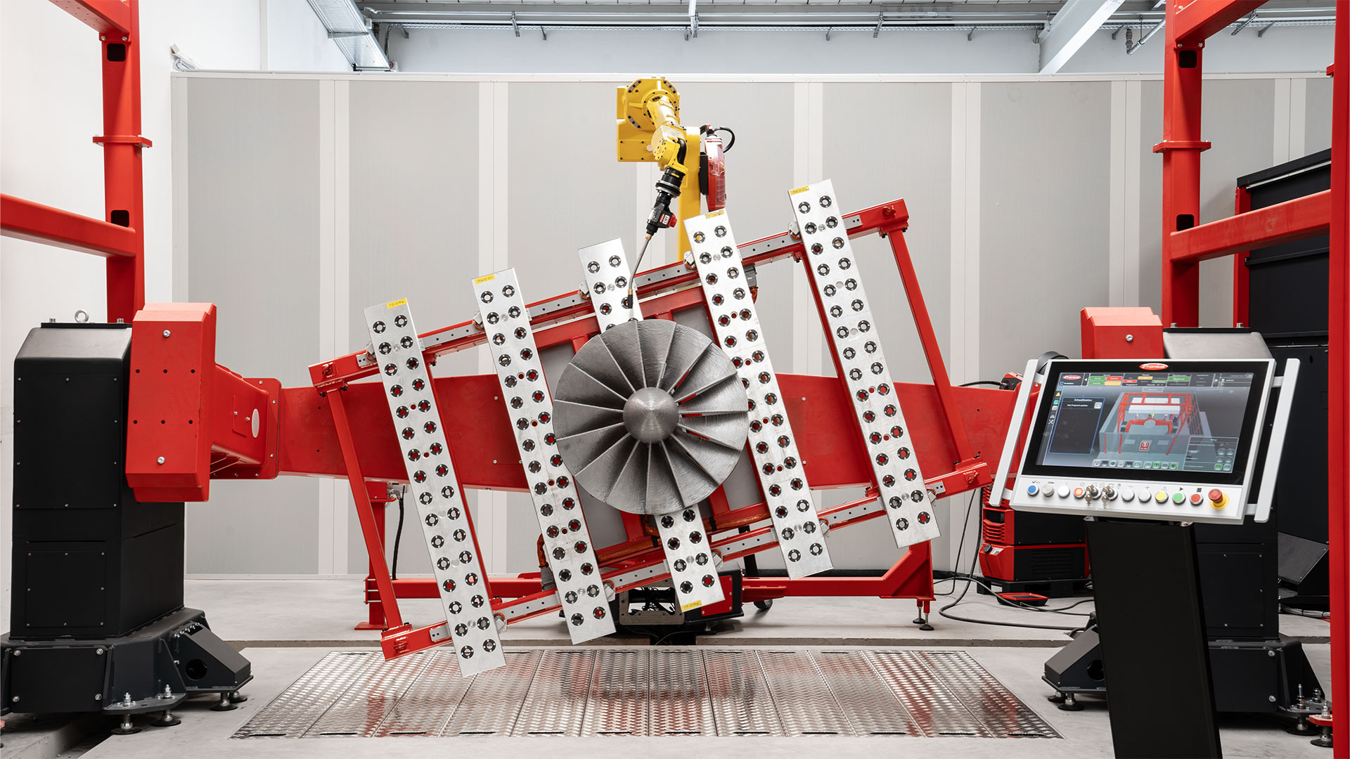

How WAAM reduces material waste compared to milling
If we compare metal 3D printing with cutting processes such as milling, it is striking that Wire Arc Additive Manufacturing (WAAM) uses significantly less material. Alternative manufacturing methods generate a great deal of scrap, since the required parts are milled out of—often enormous—blocks of metal.
While milling certain geometries can result in up to 80% material loss, this figure is often only around 20% with additive manufacturing using DED-Arc. What’s more, this 20% is only generated when finishing the component.
The metal propeller shown here was manufactured using this process. If it had been milled from a block, the block would have been 60 x 90 x 90 cm in size and weighed around 4 tons, while the finished component weighs just under 100 kg.

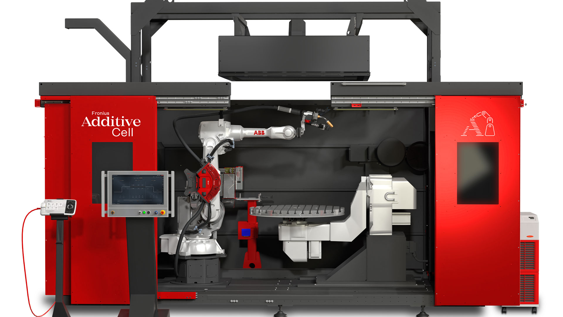

Fronius Additive Cell: your solution for agile additive manufacturing
Classic production techniques often require complex molds and tools to be constructed, and are associated with long lead times and costly set-up. “The Fronius Additive Cell provides a perfectly coordinated end-to-end system for additive manufacturing. The combination of proven welding technology, intelligent controls, and precisely balanced system components enables a stable manufacturing process,” explains Anna Dieplinger, key product manager automation solutions at Fronius International.
The proven Fronius CMT technology, combined with CMT Additive Pro and the iWave 500i AC/DC Multiprocess, ensures a smooth workflow, while the Polaris control system coordinates all system components.
The Vectris software bundle enables a simple, stable, and process-reliable additive welding application right from the planning phase. Vectris was developed specifically for additive manufacturing and consists of the Machine Tool Service Kit (MTSK) and the postprocessor. It translates the digital component design into deposition procedure specifications and identifies different component regions. The appropriate welding parameters are then adopted by the welding robot itself.
The ArcView3 camera system provides additional process reliability. It records the component manufacturing process in real time and allows continuous monitoring of the arc at millisecond intervals from a safe distance. Whether in confined production environments or when changing locations at short notice, the Fronius Additive Cell is designed to be mobile and—thanks to its portable construction—can be easily moved using a crane or forklift.
