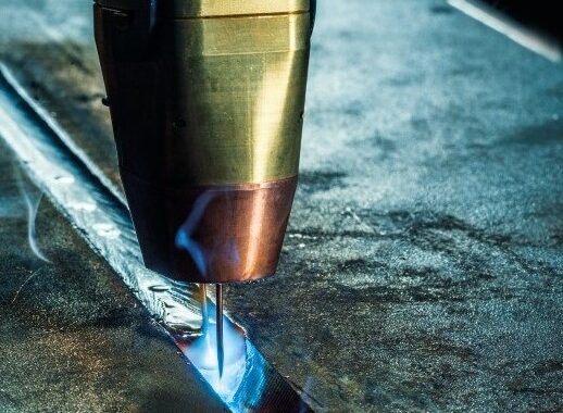

However, heavy duty welding with a wire electrode is not just about unreeling more wire; two other aspects also play a decisive role: the gas mixture and a special water-cooled welding torch with a longer stick out. Stick out is the distance between the end of the contact tip and the workpiece surface (see diagram), which is greater than with the conventional gas metal arc welding process. This means that a higher wire speed can be set for any given amperage, which in turn enables higher deposition rates. The cooling system which directly cools the gas nozzle also guarantees a high duty cycle at full power.

Tandem welding enables arcs to be controlled individually thanks to two electrically isolated contact tips in the welding torch.
