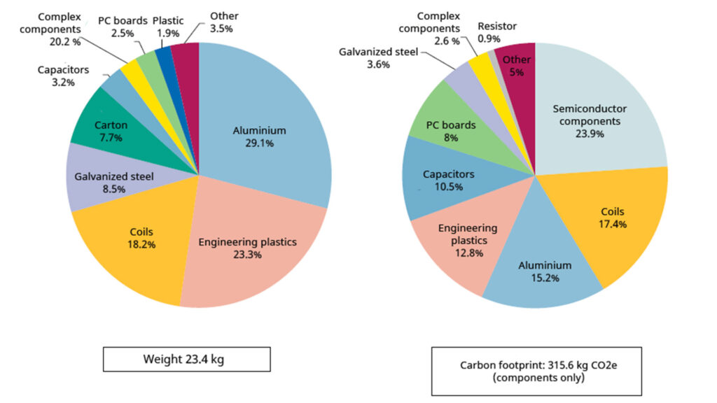

As an inverter manufacturer, we have the advantage of first-hand information: more than 40% of the total carbon footprint of the Fronius Symo GEN24 10.0 Plus is attributable to its components when the inverter is used in an Austrian photovoltaic system. What is striking is that although semiconductor components account for only a marginal .01% of the inverter’s weight, they are responsible for 23.9% of its carbon footprint at the component level. Capacitors and PC boards also count among the energy-intensive components of a Fronius inverter. Although they account for only 3.2% and 2.5% of the total weight, they are responsible for 18.5% of the total 315.6 kilograms of CO2 emitted by the components. The situation is quite the opposite when it comes to the required plastic and aluminum. As Fronius uses recycled aluminum, it has a lower environmental impact despite its high weight proportion of 29.1%. About 15.2% of the component’s carbon footprint is attributable to the light metal.
A high weight does not automatically mean a large share of CO2 emissions. Semiconductors, capacitors, and PC boards are among the most energy-intensive components of an inverter (Source: Life Cycle Assessment of Fronius GEN24 Plus)

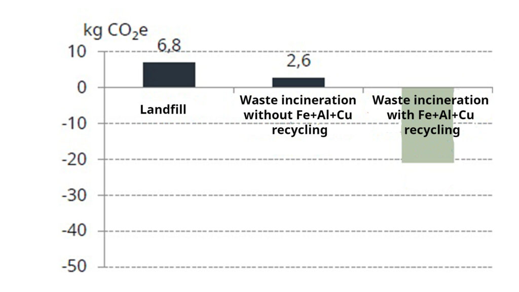

Inverters that have reached the end of their service life can also be recycled very effectively. Recycling is required by law in some countries. Austria’s “Waste Electrical and Electronic Equipment Ordinance” mandates a material recovery rate of at least 85% for inverters, PV modules, and battery storage. The aluminum used in heat sinks and housings, the copper contained in coils and wires, and the small amounts of precious metals that are essential for circuit boards are suitable for recycling. Plastics, on the other hand, are only partially recyclable. After disposal, they are usually incinerated to generate energy.
Possible waste management scenarios for the Fronius Symo GEN24 10.0 Plus. (Partial) recycling results in a CO2 credit
Overall, the disposal of solar panel components accounts for between 2 and 5% of their total greenhouse gas emissions. At the same time, recycling materials results in significant cost savings compared to extracting new ones, thereby enabling the energy-efficient production of new plant components. With efficient end-of-life management, products can even achieve a CO2 credit.
The Fronius Symo GEN24 10.0 Plus generates a CO2 credit of 20 kg through metal recycling and subsequent waste incineration. Landfill disposal and pure waste incineration, on the other hand, would generate 6.8 and 2.6 kg CO2 equivalent respectively (see chart).
