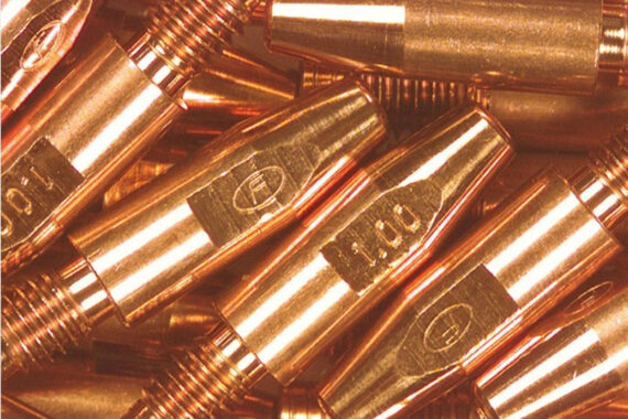

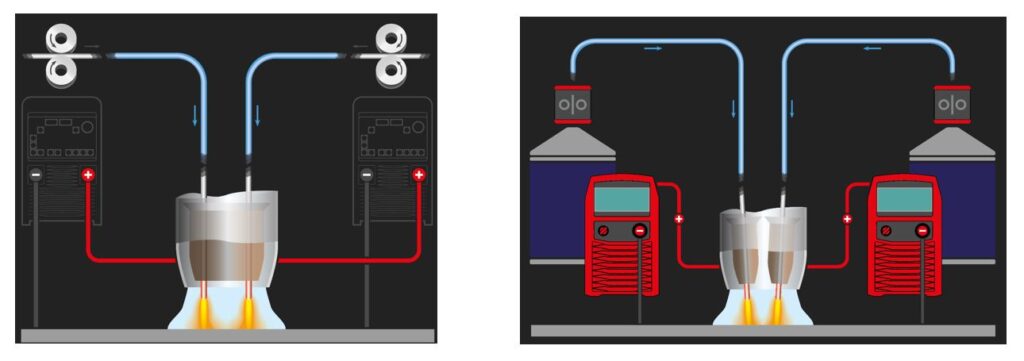

During tandem welding two wire electrodes are melted at the same time. These are routed through two electrically isolated contact tips, i.e., the potentials are separate. As a result, the arcs can be controlled independently and, despite differing outputs, can be precisely coordinated.
Differences between Double-Wire and Tandem Welding
Double-wire welding represents the very beginnings of welding using two wire electrodes (developed at Fronius around 25 years ago). Here, electrodes with the same potential (not electrically isolated) were used. These could either be fed into one single or two separate contact tips.
The disadvantages:
At the time of double-wire welding there were no suitable characteristics such as pulse or PMC (groundbreaking developments). Standard welding in the dip transfer arc used back then led to increased formation of welding spatter, which resulted in instability of the arc and fluctuating arc lengths. This produced other drawbacks in the process (e.g., adhesion of spatter on contact tip and gas nozzle).
Tandem Welding in Detail

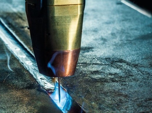

Tandem welding is based on two independent welding systems that are synchronized with one another. The separate wire electrodes are fed into a single torch hosepack via separate wirefeeders – with a single gas nozzle and electrically isolated contact tips. Two arcs generate a single weld pool.
Both wire electrodes can be synchronized accordingly using a Twin Controller: start, phase shift of the material transfer (simultaneous control of droplet detachment is not possible without phase shift), etc. In addition, a wire electrode can be connected or disconnected. Welding can be performed in both directions.
This results in a high degree of flexibility: the process is much more stable allowing very high welding speeds (2 m/min +) to be achieved on thin sheets. For thick sheets, the process boasts a high deposition rate (22 kg/h +), which allows a significantly higher weld seam volume to be achieved.

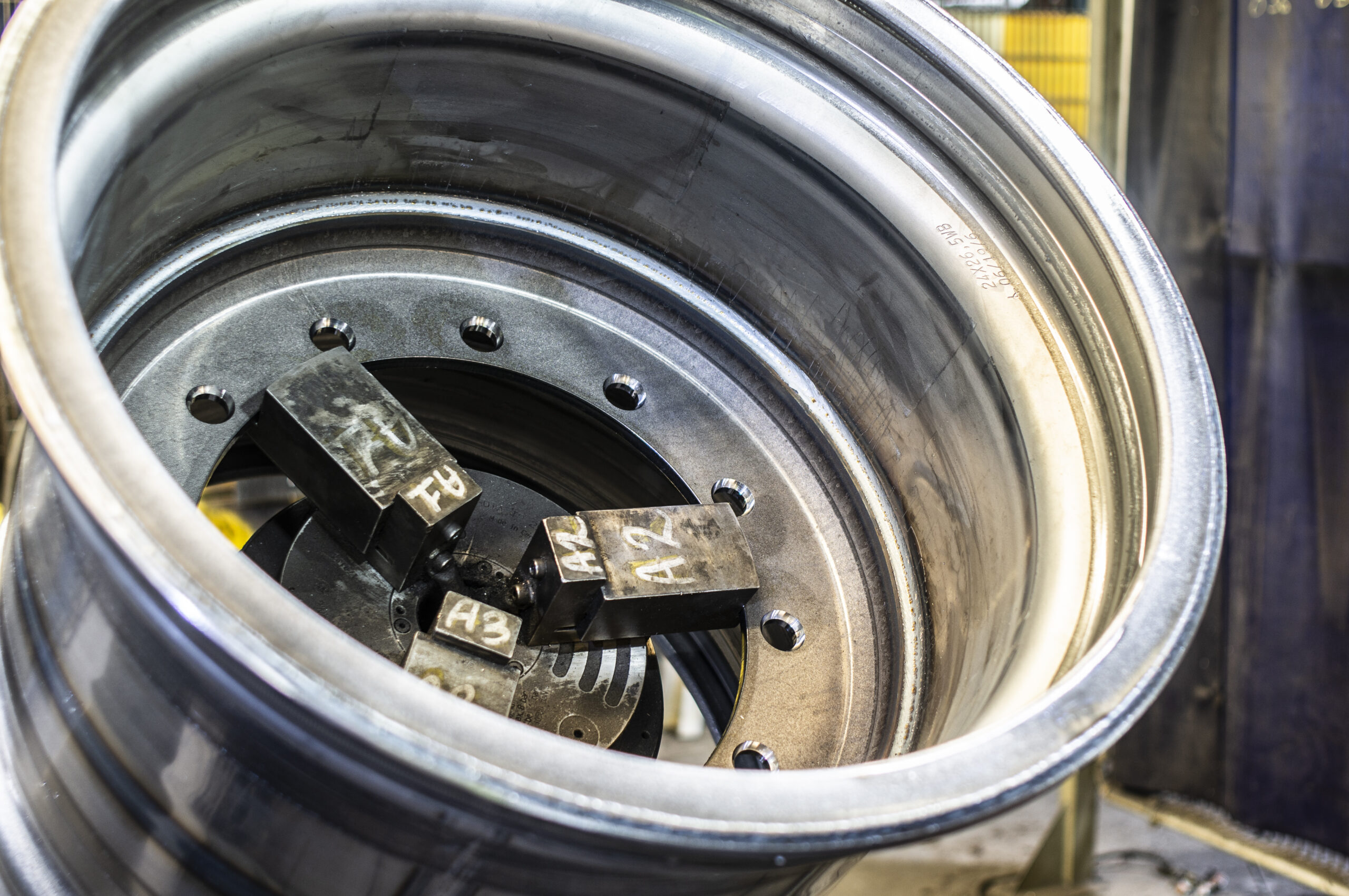

The process is highly versatile due to the high degree of flexibility and overall advantages. As such tandem welding has applications in the following industries: Yellow Goods (construction machinery), Commercial Transport (vehicle and rail vehicle construction), Automotive Industry (supply industry), and General Industry (container construction).
Examples: Welding in the construction machinery sector brings its own challenges. It is often necessary to switch between single wire and tandem welding: this can be done by swapping the torch body or simply disconnecting an electrode. This enables difficult to access parts to be welded, for example.
Welding challenges in the field of rail vehicle construction can also be addressed appropriately: in particular for the floor, wall, and roof structures of high-speed trains, very high welding speeds (extremely long weld seams) are required. Moreover, extruded profiles (usually made from aluminum) need to be joined with the least possible distortion, and the visible weld seams must represent outstanding quality – another benefit of the tandem process.
