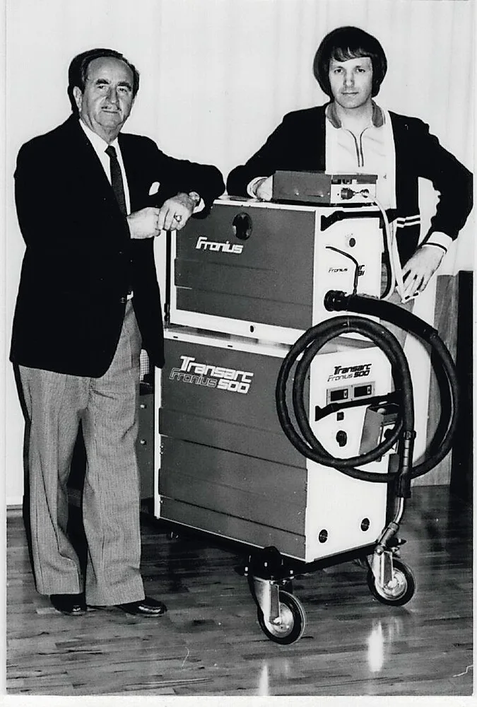

Inverter technology in place of old analog welding machines
The Transarc 500 with inverter technology, first launched on the market in 1981, represents a quantum leap in the development of welding machines and welding processes. Compared to the relatively simple analog welding machines that had been widely used until then, inverter welding machines require up to a third less power.
In practice, it’s obvious that inverter machines are significantly more energy-efficient because they hardly heat up at all compared to their analog counterparts. The current drawn by inverter machines is therefore predominantly used for the welding work itself, whereas with analog machines a significant amount of energy is wasted in the form of heat. A further important distinguishing feature is the lighter and more compact nature of inverter welding machines, due to the significantly smaller welding transformer. This makes them more mobile than analog welding machines.
So if you still own an analog welding machine, you have already contributed towards energy efficiency simply by switching to inverter technology.

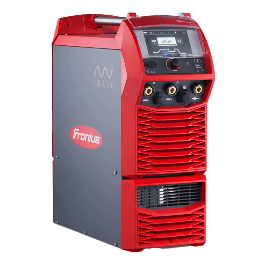

Not all inverter machines are the same
However, there are also measurable variations between different inverter machines in terms of energy consumption, especially as leading manufacturers of welding machines are constantly striving to optimize the energy efficiency of their products.
For example, the power factor correction in modern inverter welding machines helps to increase efficiency. In models with a power factor of over Cos φ 0.95, almost all of the energy drawn from the grid for welding is used for this very purpose.
State-of-the-art inverter machines consume less power than machines that are already somewhat outdated. A series of tests carried out by Fronius at the beginning of 2024 can confirm this—a modern inverter model was directly compared with an inverter machine with slightly older technology in industrial operation. The results were clear: the older inverter welding machine consumes 255 kWh more electricity per year.
In terms of the electricity costs of the individual machine, this may seem rather negligible. But with countless welding machines in use around the world, the higher consumption of 255 kWh per year does make a difference in terms of overall energy consumption, the required power plant capacities, and the energy costs.

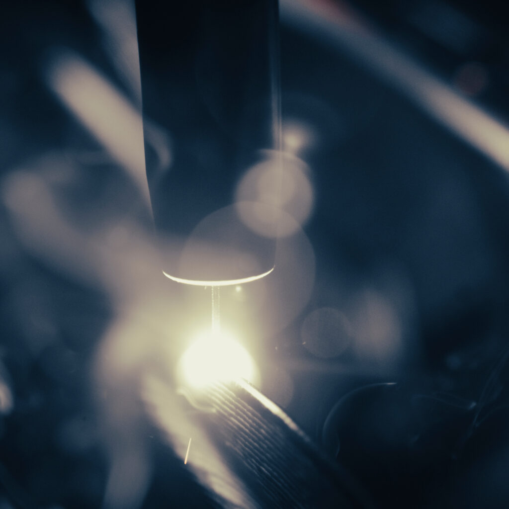

Digitalization enhances energy efficiency
Although the further development of hardware continues to play an important role in welding technology, significant software innovations are now also being introduced. Digital innovations form the basis for new welding methods and processes that make welding more efficient and also have a positive impact on energy consumption.
One example of this is the CMT process developed by Fronius. CMT stands for Cold Metal Transfer, a process that is characterized by a precisely controlled current feed, an extremely stable arc, and a very low heat input. This reduces the distortion of the base workpiece and the volume of waste. All these factors help to save energy.
