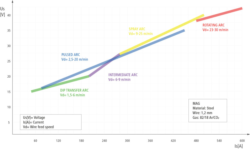

Arc Types
The arc is a basic requirement for MIG/MAG welding. It is created by closing the circuit between the electrode and the workpiece. The wire electrode almost always has positive polarity. During the arc phase, the material transfers dynamically from the consumable electrode to the workpiece. This process – and therefore the type of arc – depends on the voltage and the wire speed. If the voltage and wire speed increase, the droplet volume increases and the material transfer becomes short circuit-free.
Generally speaking, arc types are divided into four different categories, but the boundaries between these categories are fluid. During MIG welding, either a spray arc or a pulsed arc is usually used. Dip transfer arcs, intermediate arcs, spray arcs, and pulsed arcs can all be used with MAG welding.

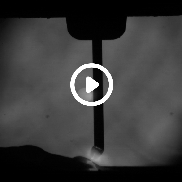

Kurzlichtbogen
Dip transfer arcs are in the lower power range – in other words, they are associated with a low voltage and a low wire speed. With the dip transfer arc, welding is possible in virtually any position. There is minimal spattering and the arc can be controlled very effectively. It is particularly suited to welding light gauge sheets and root passes.

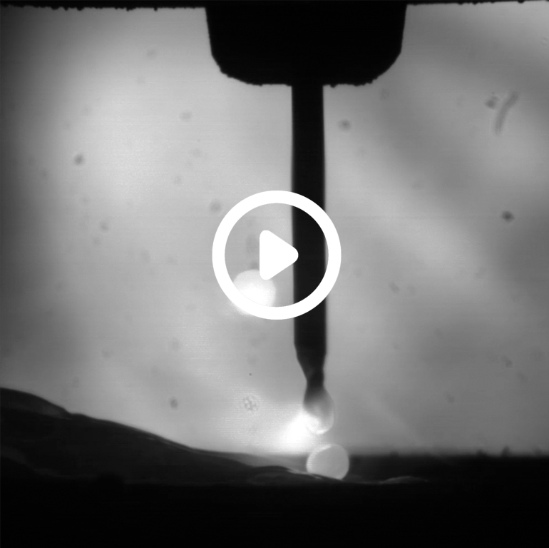

Uebergangslichtbogen
With intermediate arcs, short circuits and spray transfers alternate at irregular intervals. This leads to increased spattering – meaning that this particular arc type should be avoided as far as possible.

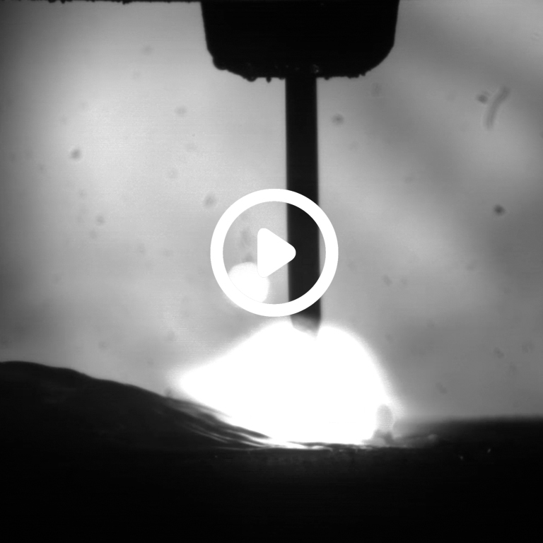

Spruehlichtbogen
Spray arcs burn continuously without short circuit interruption. The filler metal transfers at high speed and in fine droplets into the weld pool. A degree of heat input into the workpiece, a high deposition rate, and deep penetration are all characteristics of the spray arc. For this reason, it is ideal for welding thicker sheets.

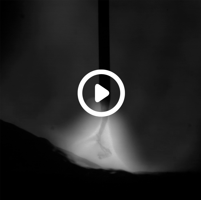

Impulslichtbogen
When using pulsed arcs, the material transfer is controlled using pulses in order to avoid unwanted short circuits. This results in an extremely low-spatter, versatile arc. Welders can produce high quality results, even with different materials and different thicknesses.

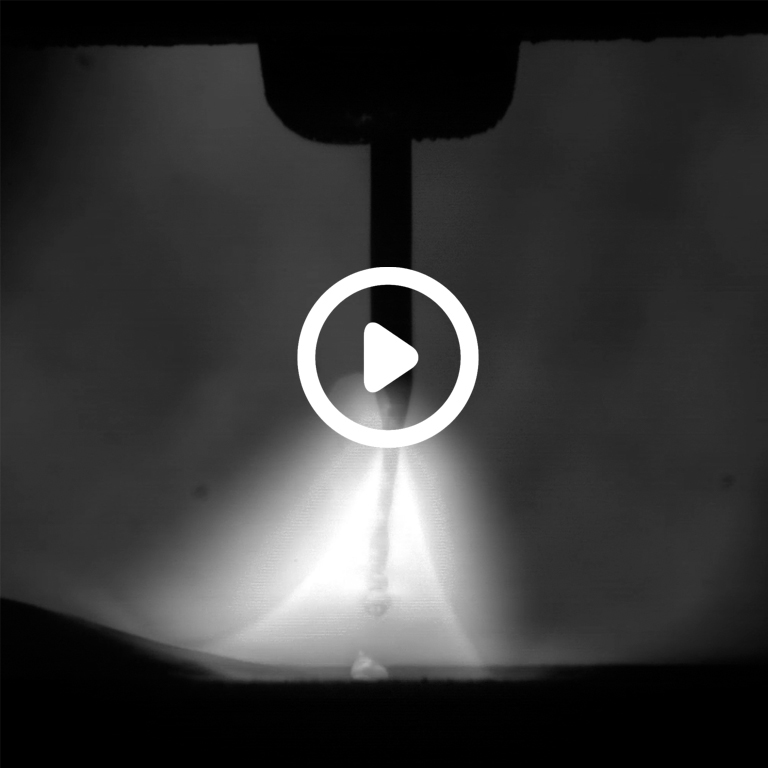

rotierender Lichtbogen
Rotating arcs are particularly powerful and ideally suited to welding thick workpieces, thanks to their high heat input. The droplet is deflected to the side when it detaches from the wire electrode and is transferred to the weld pool in a rotating motion. This process can only be used with mechanized systems, which limits the number of suitable applications.

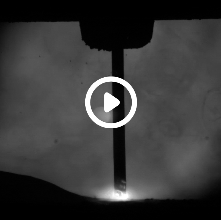

kombinierter Lichtbogen
Combined arcs are often made up of pulsed arcs and dip transfer arcs. The pulsed arc creates the necessary penetration and heat input, while the dip transfer arc ensures improved controllability of the weld pool. This type of arc is often used for welding out-of-position.
MIG-MAG-arc-types
The arc types based on an example: MAG steel welding with 1.2 mm wire
